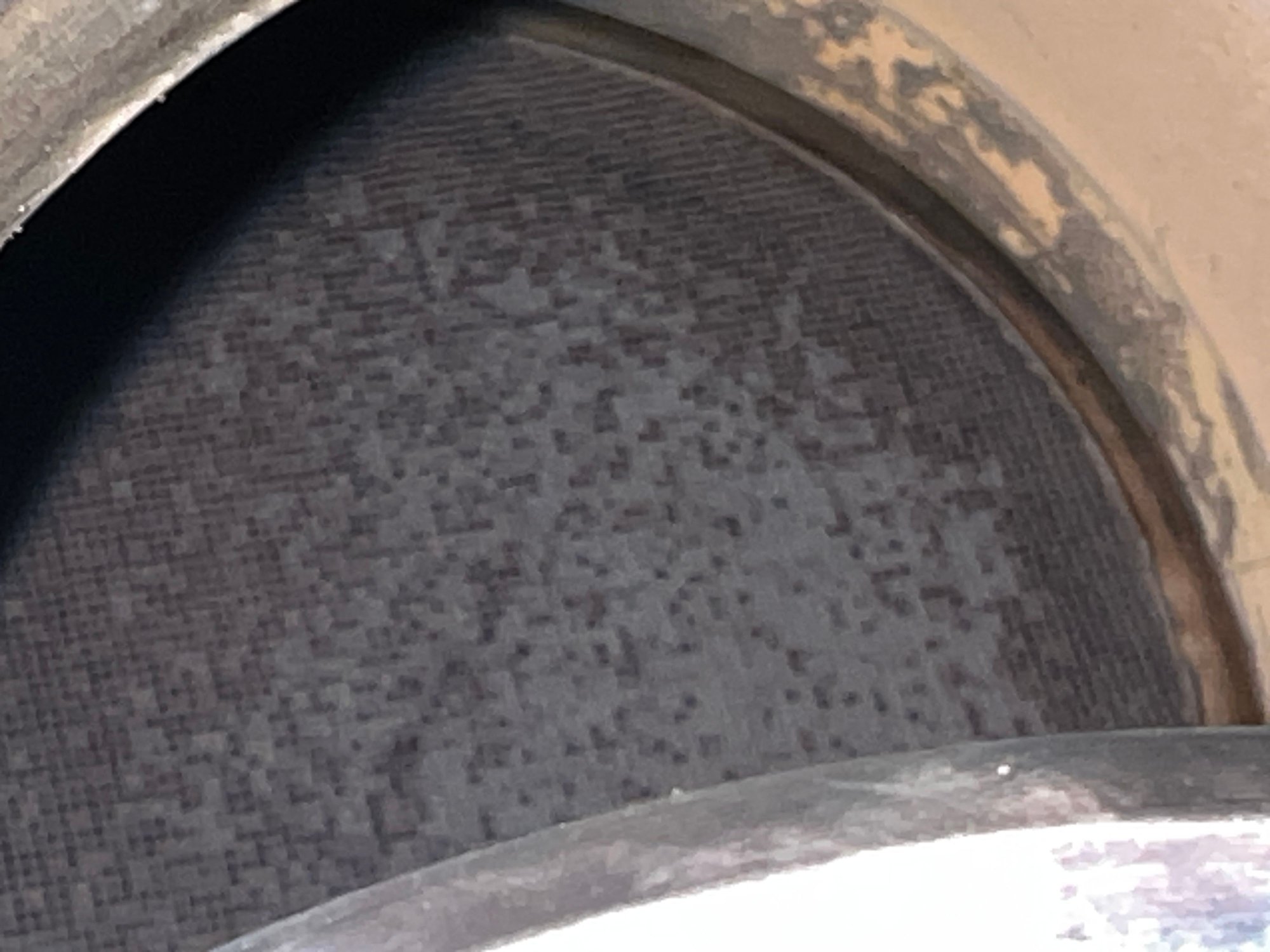

there is place specialist for catalytic carbon cleaning they checked them by the camer
a in the end cleaning went well from up pipe didn’t have to remove them and but them into the water machine as they do here and the car got much smoother than before
note: the pictures after the cleaning before one of the bank was fully white clogs
They did a very good job with the cleaning. Nice 👏
https://cimg2.ibsrv.net/gimg/www.mbw...08d646196.jpeg
https://cimg3.ibsrv.net/gimg/www.mbw...c6a070003.jpeg
That is very clean : )
