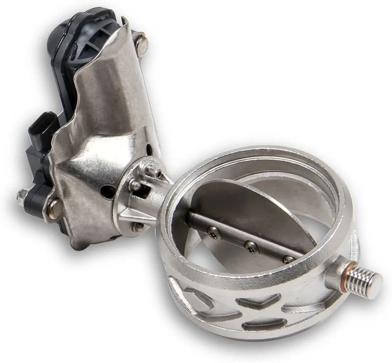

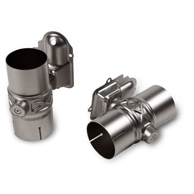

If you want to keep the signature AMG sound and need to entirely replace your H-pipe the two best options are:
Hooker Blackheart flap 71013001-RHKR
Akrapovic valve actuator flap for C63 S
