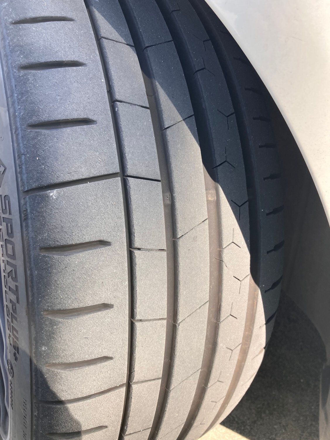

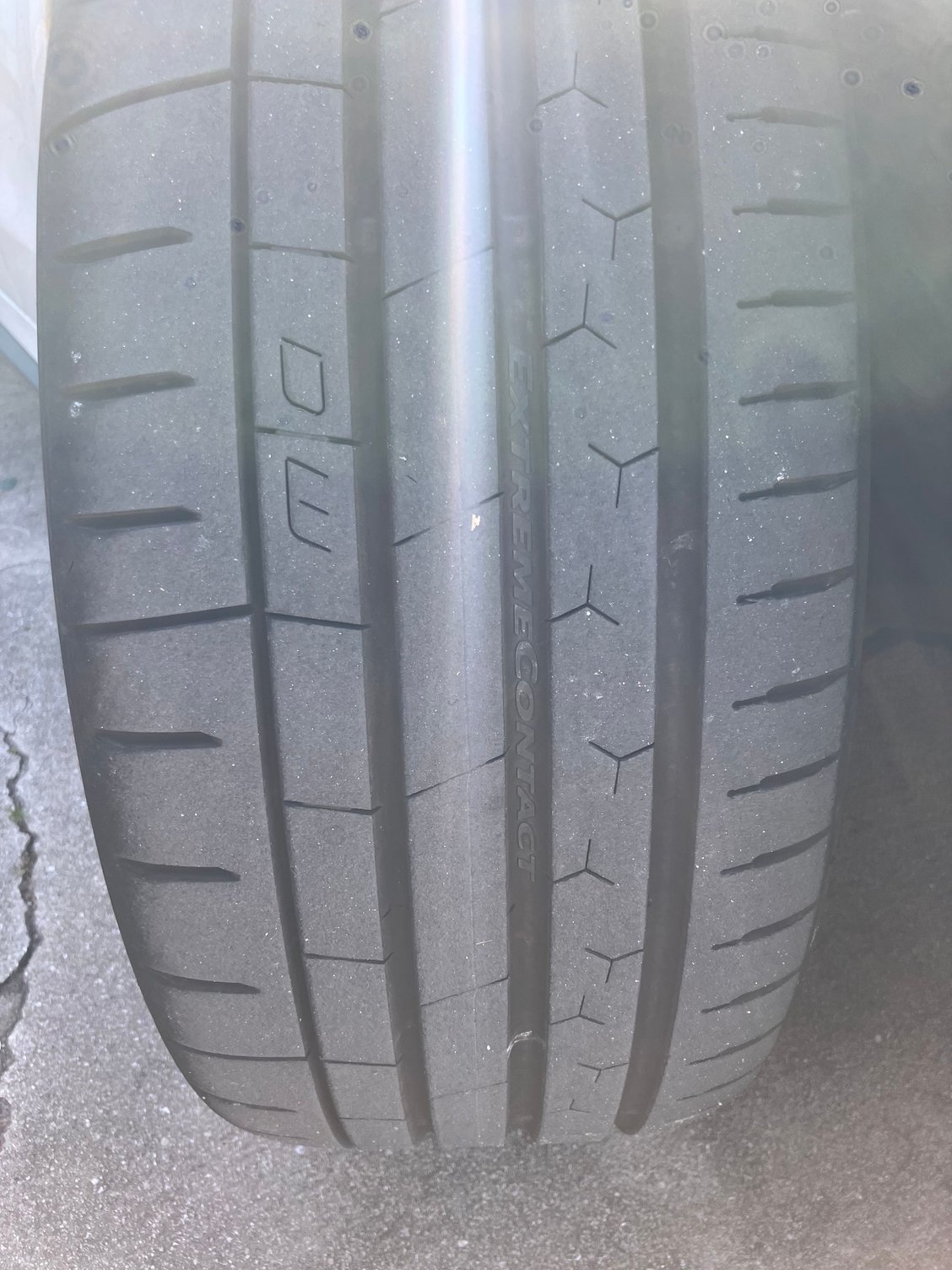

i’m very well aware and got your unsolicited private message about it. So far -2.2 on max summer tires is giving me even tire wear across. With endurance 200 and flipping them as needed I should be fine at the sweet spot. 1/32 and 3/32 toe has fixed inside tire wear for me. 10k on ECS02 and 6/32 deep on outside inside and center of tire. With auto X use.
if I ever bump into a open class, I’ll consider your bushings. As then I’m allowed to play with that. But in F stock class I am not allowed camber bushings.
