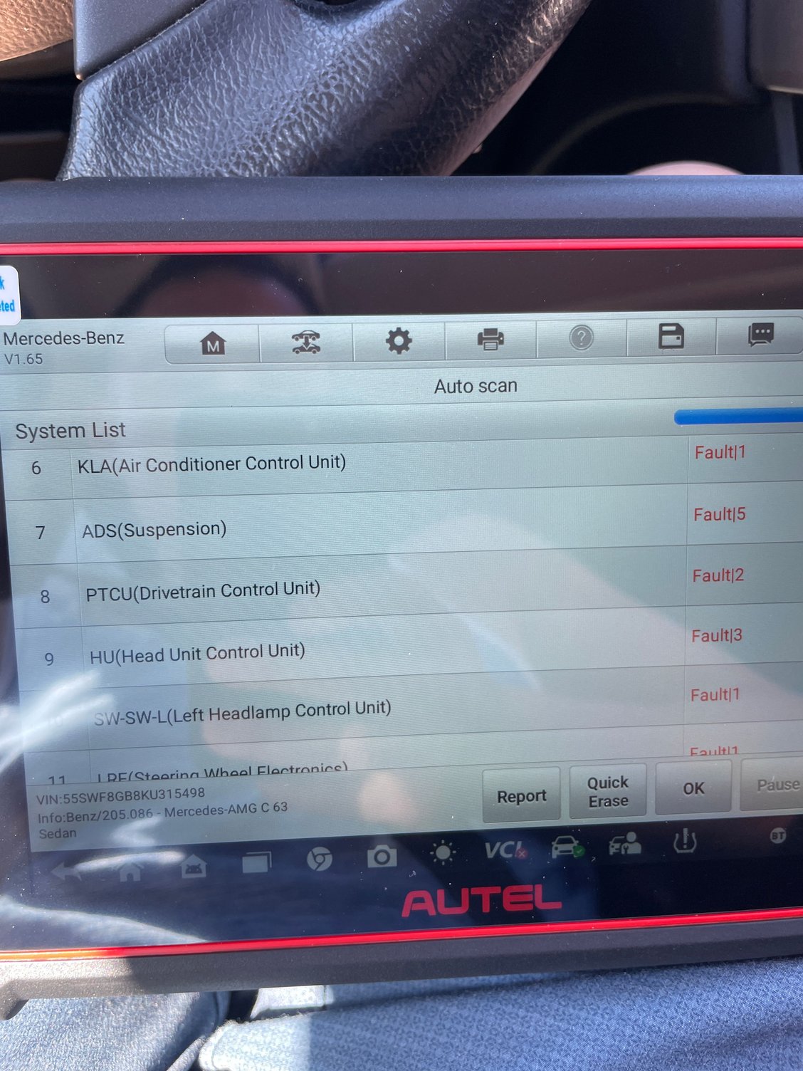

Got my Autel and this is the diagnostic.
will the PTCU really limp mode my car?

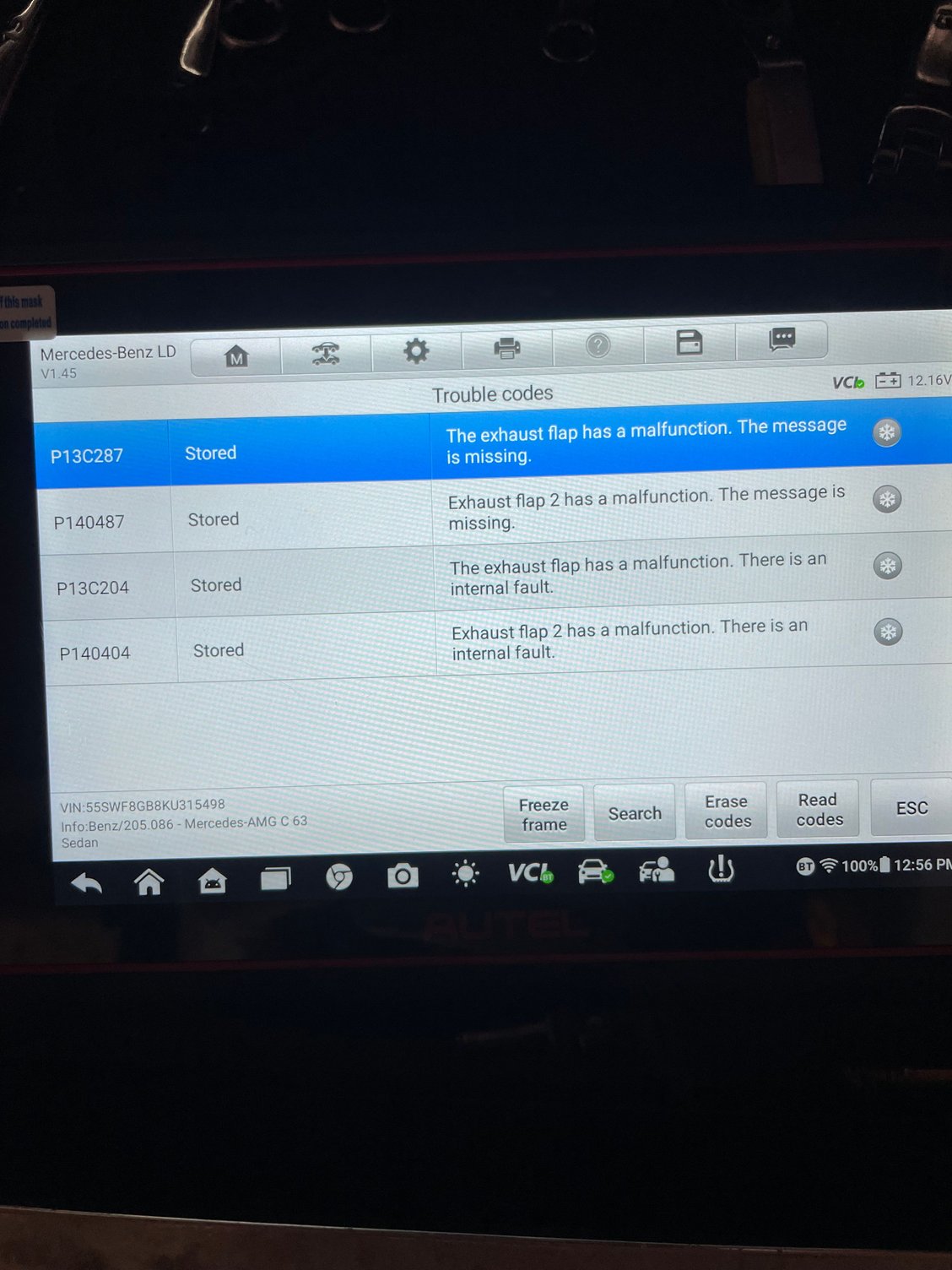

dive deep and saw P140404 exhaust flap 2 malfunction.
where is this location and is it a easy fix.

I think if you posted the codes like you did for the exhaust flap it would be helpful. Looks like you have some stuff to correct. Exhaust Flap 2 should be one of the rear active exhaust servos by the mufflers. They are not hard to replace. The MB servos are expensive, but I there is a Ford active exhaust servo part that is cheaper and that some people on this forum have said is an alternative direct replacement.

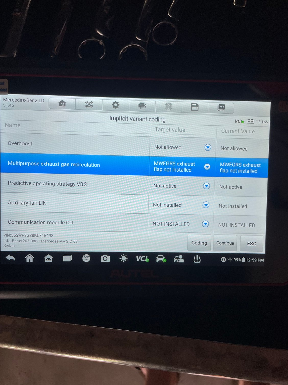

Ok, so I test again and here are the faults. No faults in the PCV system and this Autel doesn’t have the function to turn the pcv on or off.
however, I try to find the function to turn off the exhaust flaps and couldn’t find it. Only thing in the Autel is multipurpose exhaust regulation and it came up saying none installed, which is odd.
i took off the flap assembly on both mufflers and they seem to be working. I can see both spring moving about 1/4 turn each time I turn the car on and off. But no movement when I switch it from C to S+.
can the Autel take my car off of limp mode? And how?

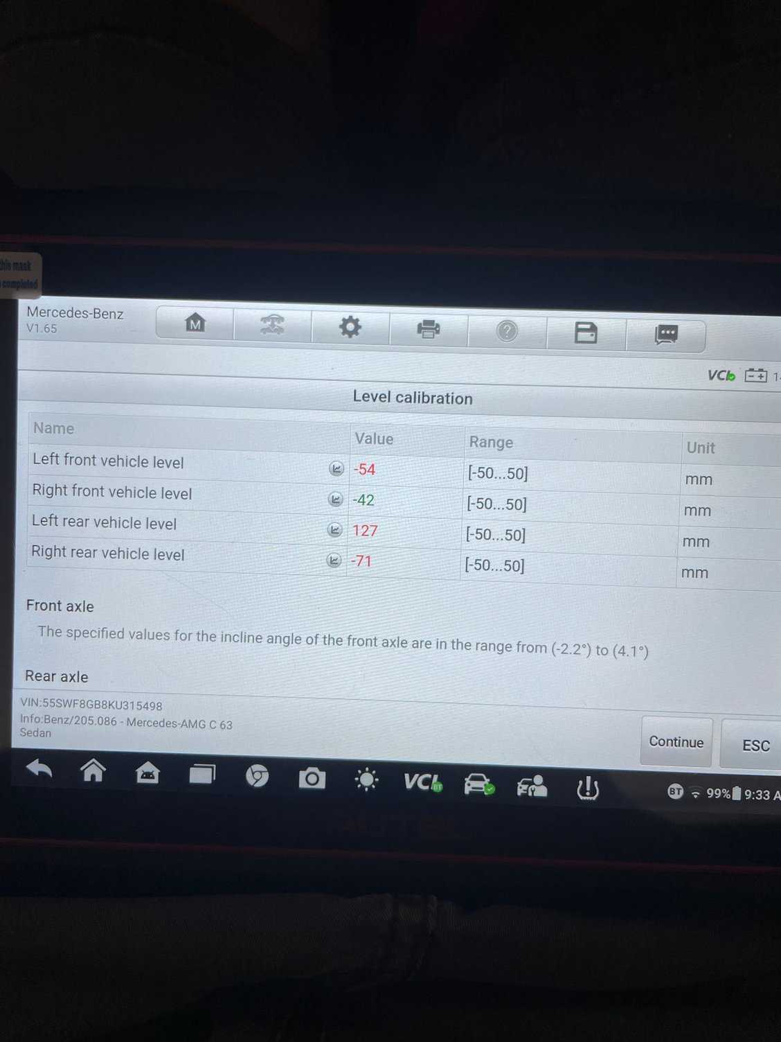

however, in the mix of things. I accidentally went in an calibrated my suspension and now the car suspension is in limp mode. Does anyone now what our stock level suspension value is set at?
2019 sedan C63 with the stock black 19” wheels
front right
front left
rear Right
rear Left

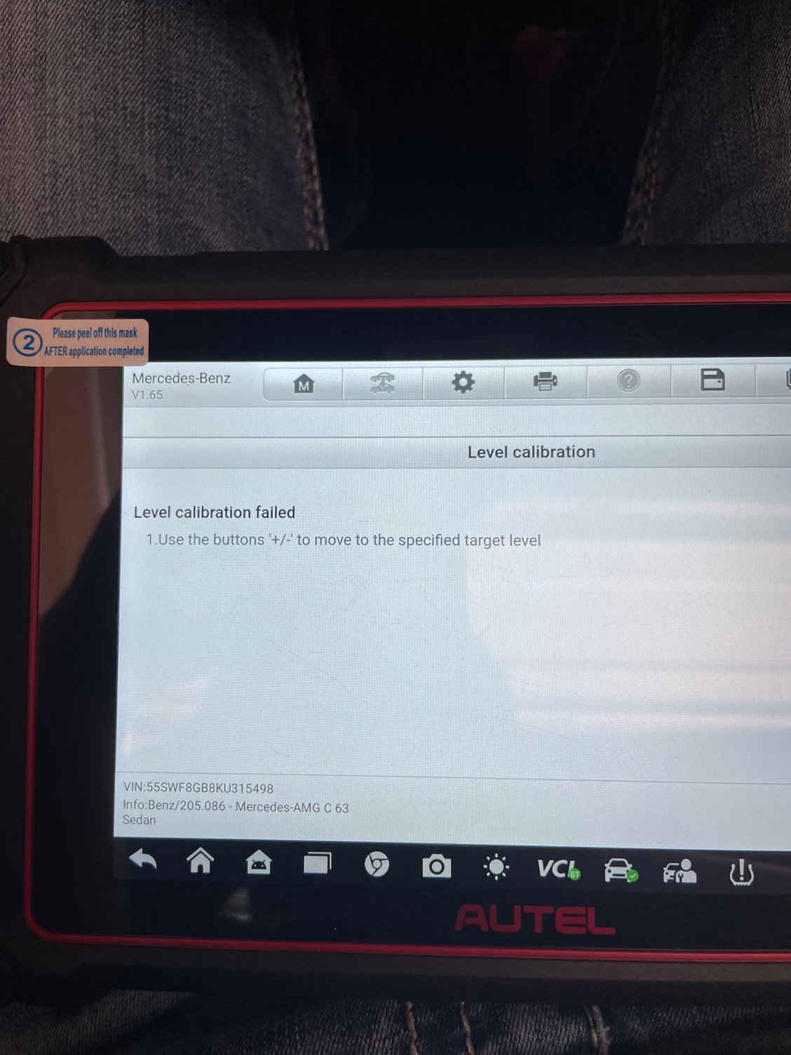

No luck with benzninja.
hopefully someone here had some knowledge on how to do this ADS Suspension level calibration.
there is one issue that I have. I enter a few number between what was given and it errors out.
Not sure where the +\- in the system to even make adjustments.

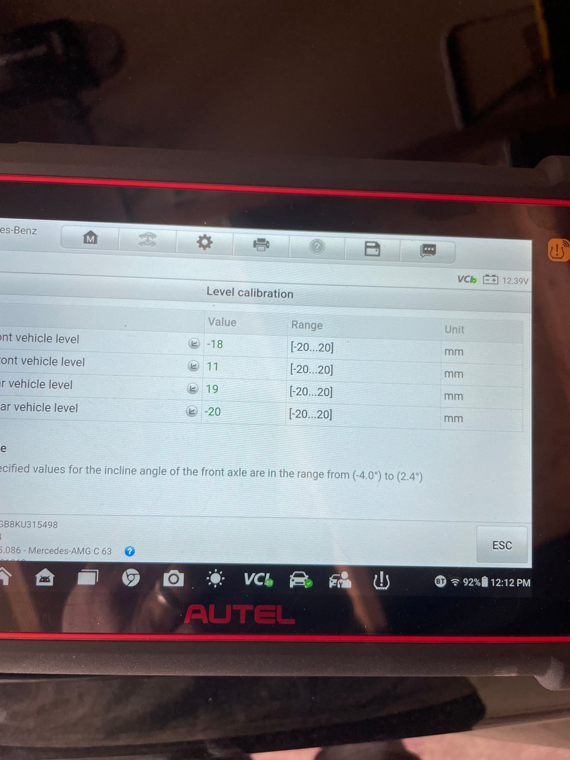

however, did some more digging and notice that one of my height is out of range, 127, you can see it in the diagnostics screen. So I’ve been jacking the car up and down since it’s reading mm instead of voltage. this is done on all 4 corners to get the range back into spec. Notice the high 127 was due to a bad installation of the level sensor, installed reversed after camber arms were installed. Got that corrected. Now just waiting on the car to reset 10-15 minutes with closed and locked doors. Will report back if I get it corrected.

YAY, got it corrected. Hope someone else who runs into this problem will see this post.
here’s what I’ve done. All four corners, raise it until you are within spec, this is better than voltage reading.
then, input the values display on the diagnostic, front angle range was -4 to 2.8
and rear was -2.5 to 1.9
take values in between. Mine was -.8 front and -.5 rear.
the car was happy and accept it.
