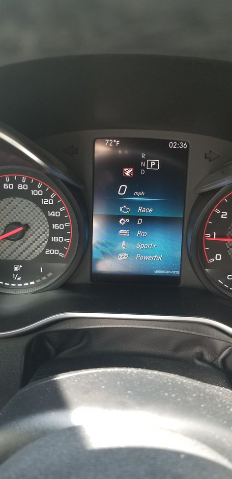

Originally Posted by jj18
So for the FL, the AMG Dynamics mode BASIC, ADVANCED, PRO and. MASTER settings can only be applied when the car is set to the INDIVIDUAL setting knob? Otherwise those individual setting above do not apply when I change the driving mode(knob) to SLIPPERY, COMFORT. SPORTS, SPORTS+ and RACE?
Yes, they apply in every drive mode.
  • Slippery and Comfort set it to BASIC
  • Sport sets it to ADVANCED
  • Sport+ sets it to PRO
  • Race sets it to PRO if ESP is ON, MASTER if ESP is OFF or in Sport Handling
  • Individual sets it to whatever you configure it, but MASTER is only available if ESP is OFF or in Sport Handling. If you configure it to MASTER, it automatically reverts to PRO when you select Individual mode unless you turn ESP off or put it in Sport Handling. Same behavior as Race.
Best way to see that, is if you bring up the AMG PERFORMANCE display in the instrument cluster as shown below. The left display shows the breakdown of the individual components, so as you change drive mode you can see how that affects each component and you can see what mode AMG DYNAMICS is in.

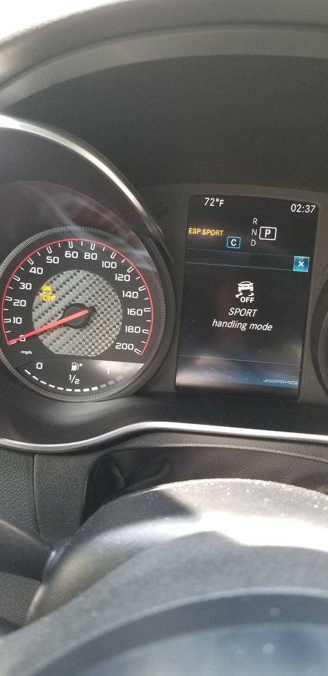

Old Jun 2, 2025 | 04:36 PM
jj18's Avatar
Joined: Mar 2019
Posts: 595
Likes: 96
From: NYC area
2019 C63S Coupe
photos shows, I believe, the setting are more or less where they should be
