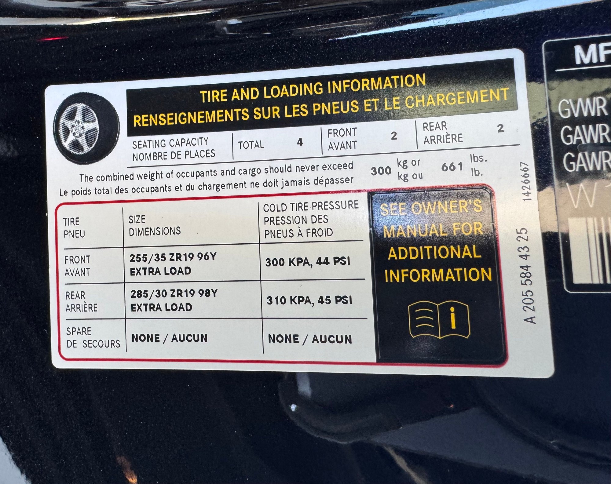

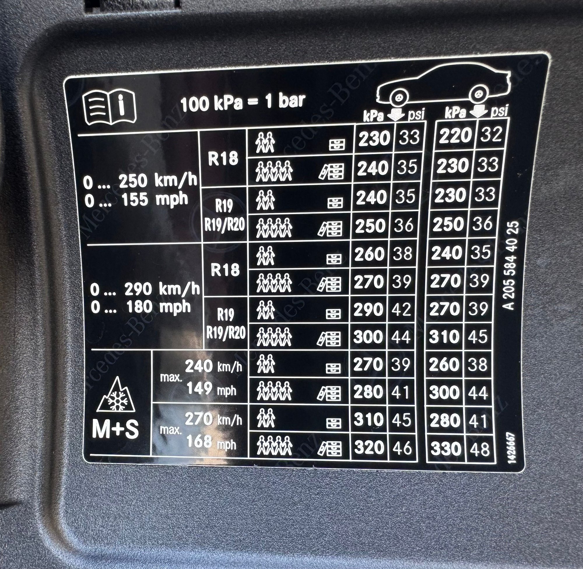

Which tire pressure for 2020 C63 coupe on 19?
Door jamb and gas door seem to say different things?

Door jamb is MAXIMUM tire psi at full vehicle weight, I believe. Just go off gas door for regular street driving.

On MBs, always use the pressures on the fuel door.

ALWAYS use the fuel door pressures.

As said above, the fuel door sticker is what you should use based on the load, speed and types of tires. The door jamb sticker corresponds to the last row above the M+S section. That's what's known as the max load pressure for the tires your car came with. You have different pressures on yours than my 2019. Might be because I have the lightweight 5-spoke AMG forged wheels. Those are super light. The ones most people option are heavier wheels. I run 33f and 32r as per the fuel door sticker for normal load and speeds up to 155 mph on 19/20" tires. Ran the higher pressure during my European Delivery trip when I was doing speeds above 155 mph, but eventually lowered them and just kept an eye on the tire temperature. For short bursts above 155 mph, the pressures don't really need to be increased. The ride quality gets pretty harsh at the higher pressures.

I have mine at 42 psi, the mercedes me app has a green tick
michelin pilot 4 tyres

Be very careful. I bent 3 wheels with that PSI spec. I have the same RXC wheels as you, they bend very very easily. After I went to 42 PSI all around, no more bent wheels thankfully.
