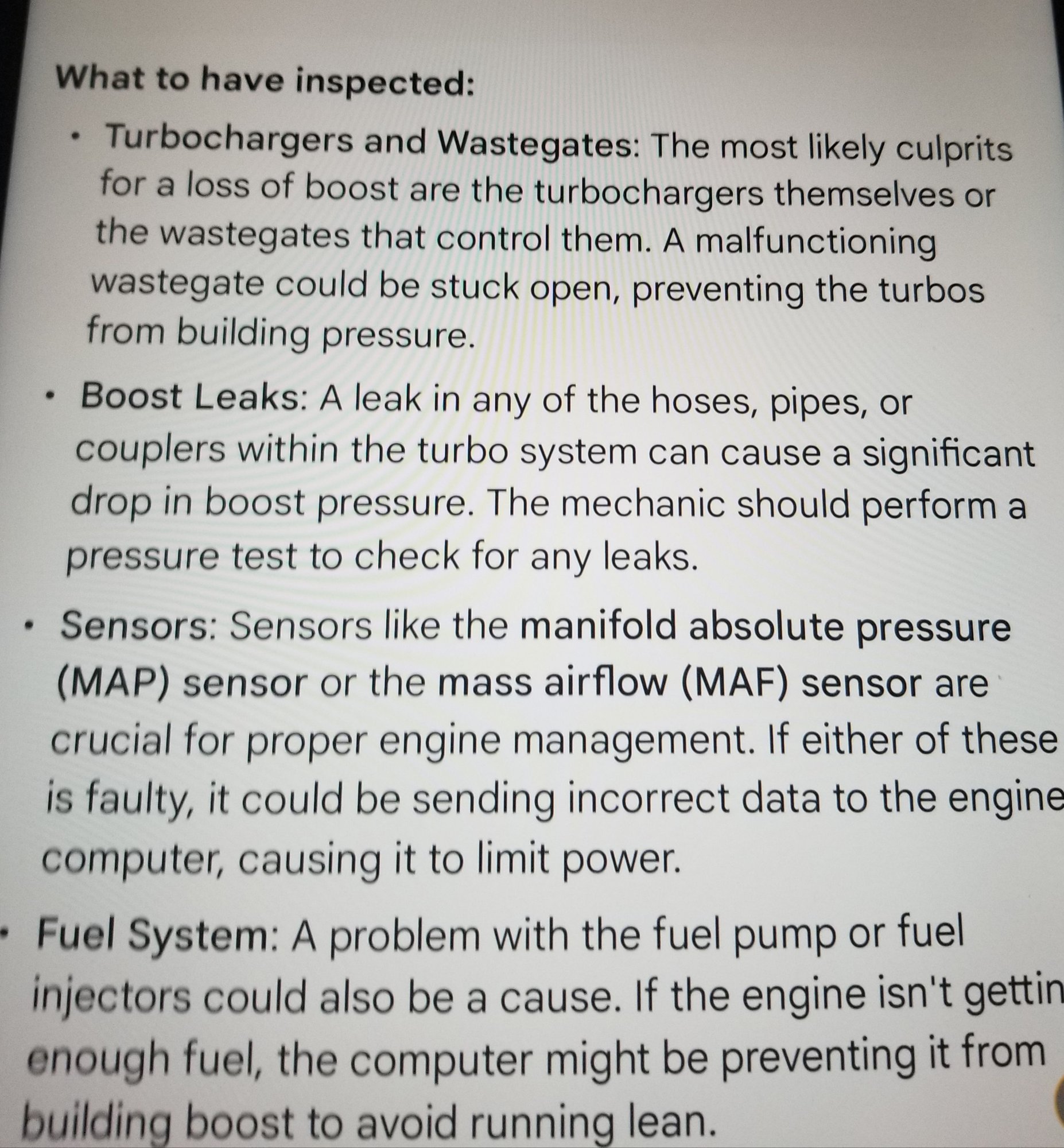

Originally Posted by C63sB
yeah i have no idea what's going on with this car, just took it out tonight weather is cold nice boost weather and the car was pulling nice with no issues lol
Like i said sometimes its fine sometimes it just drives with no boost/power after shifting gears
Old Aug 29, 2025 | 07:27 PM
C63sB's Avatar
Joined: Jun 2025
Posts: 13
C63s
Yup used a better tool to read codes and it gave me a MAF sensor , i think that's what's causing the car not to push power
Gonna clean that sensor and hopefully problem is fixed
