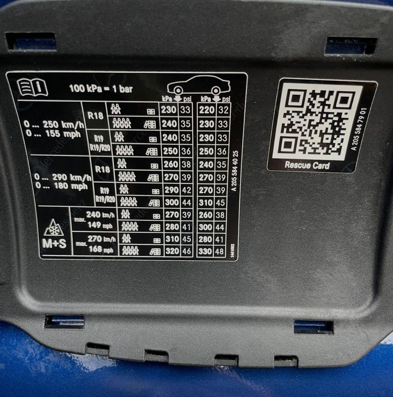

Speed rating always has to be looked at together with tire pressure. The issue is what's called tire deflection. It's the compression and deformation of the tire when it makes contact with the pavement. The more the tire compresses and deforms, the more heat this generates and so you may overheat the tire, even if the speed rating technically supports the speed. So that's why you need to increase the tire pressure for speeds above 250 km/h and with soft tires. Below is the pressure chart and while AMG only give pressures for M+S tires, which are not full snow tires, you can see that they need higher pressure. For higher speed Autobahn driving you essentially need to inflate them to 2.8 bar in the front and 3 bar in the rear. Looks like you had them underinflated for starters. If the tires are particularly soft as Hankooks are, you may have needed to inflate them even higher to compensate for the softer compound. But as said, winter tires aren't really made for higher speed driving, so save it for the warmer months on summer performance tires.

Interesting. You have different numbers and more detail for M+S tires.

Interesting.
I think thats country specific.
If you see no 19/20 wintertire but its in my country legal to use this size
(like summer tire). MB says use 19/19 for winter but I say no - car should allways look pretty .
The sticker has a partnumber maybe its correlated
with Code 250 ( drivers package ~ 180 mph) too ?
