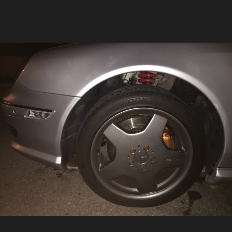

If I was going to be tracking my CL, I'd consider doing some kind of mod
but for now my car's suspension is great. Only problem is that I don't
have the option of lowering my car like before......and my front end is a bit high......Other than that, I'm happy overall with Strutmasters....

You can fill that wheel well gap by getting higher profile tires such as 50 or 55 series
The yellow speed coil overs should allow lowering
No one has tried them yet and posted about it
https://mbworld.org/forums/cl-class-...coilovers.html
