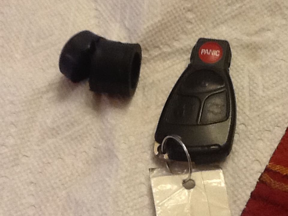

The new to me cl600 sprung a coolant leak on its first drive around town.
At least it waited until I got home to let me know.
The radiator was replaced not long ago. I have the receipt, and it appears new.
My question is on the upper hose, where it turns down, on the right side as you are facing the engine. Under the air snorkel. There is a plastic coupler, which has a thumb sized nipple sticking down. On this car, a rubber cap was placed there, which failed. The on line diagrams I am finding are showing this nipple with a 6-8 inch hose coming off. Where is it supposed to go?
Also, will losing the coolant trip the ABC fault system? These two things happened almost at same time.

All seems fine now. Can't take a picture. The plastic nipple/spout I'm talking about is buried and faces down. The ABC message is gone. I think coolant was spraying on the belt, allwing the pump pully to slip.
This hose runs from the top center, down the right side as you face the engine. The parts diagram of the hose shows another hose connected to the small spout. Not a cap.
Any help on what the smaller coolant hose should connect to? I'm thinking possibly the intercooler has been bypassed. I'll get it up in the air and investigate further.
I'll try and find a picture to post.

This is what it appears I have, with a cap on the small hose:
Is the correct hose diagram the one on the right? If so, where does the small hose (number 10) connect to?

I believe it goes to an additional radiator. But i'd have to look exactly. There's a ton of hoses in the front of the v12 cars

Aux radiator for the win.
