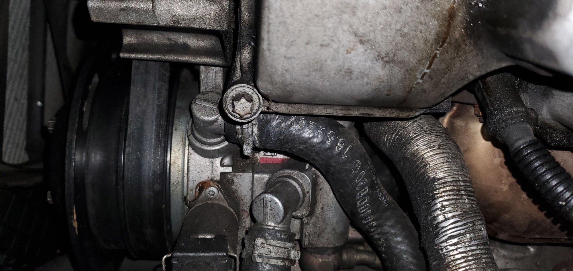

Ball joint
also how to plug the connectors??any ideas cut off quick connect and plug???or will dust cover work??

Originally Posted by R jarmoszko
Ball joint
don't know sorry, don't have that on mine

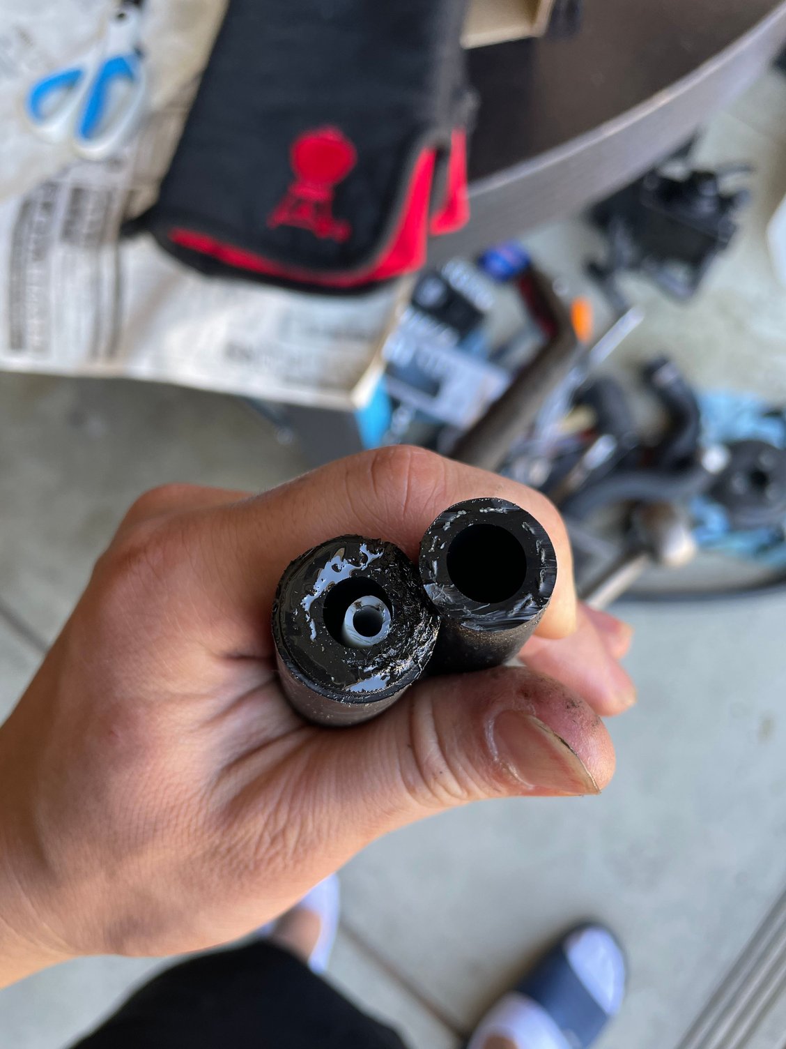

Reviving old thread
I am doing this method on my 05 CL600 and wanted to show a photo of the pipe I cut from the pump to the pulsation damper, when compared with the pipe to the reservoir. The ABC pump uses a thick insulation around a small plastic pipe. I am assuming the fluid only travels through the small pipe? Pmercury or anyone else can chime in?
If that's the case, I just need to adapt this small white hose to the reservoir hose to complete my circuit. The small white hose is 4mm ID and the reservoir hose is 10mm ID.
Left is the pump to pulsation damper pipe, right is the reservoir pipe
4mm ID to 10mm ID barb fitting
Old Jun 2, 2021 | 12:25 AM

Originally Posted by Odai Attal
Hey 👋 can you help me please? im really confused, what exactly i need to do to re-route my pump so i dont keep my abc side of the pump dry !! one of the front valve line exploded and i want to get rid of the ABC system but keep the pump. You are much appreciated
Looks like you have a V8. Which line blew? Any photos of. the blown line?
In any case, you can swap the pump for a non-ABC pump from another V8 Mercedes like an S class or an E class, or do the re-route from the wheel well method found in the previous posts.
