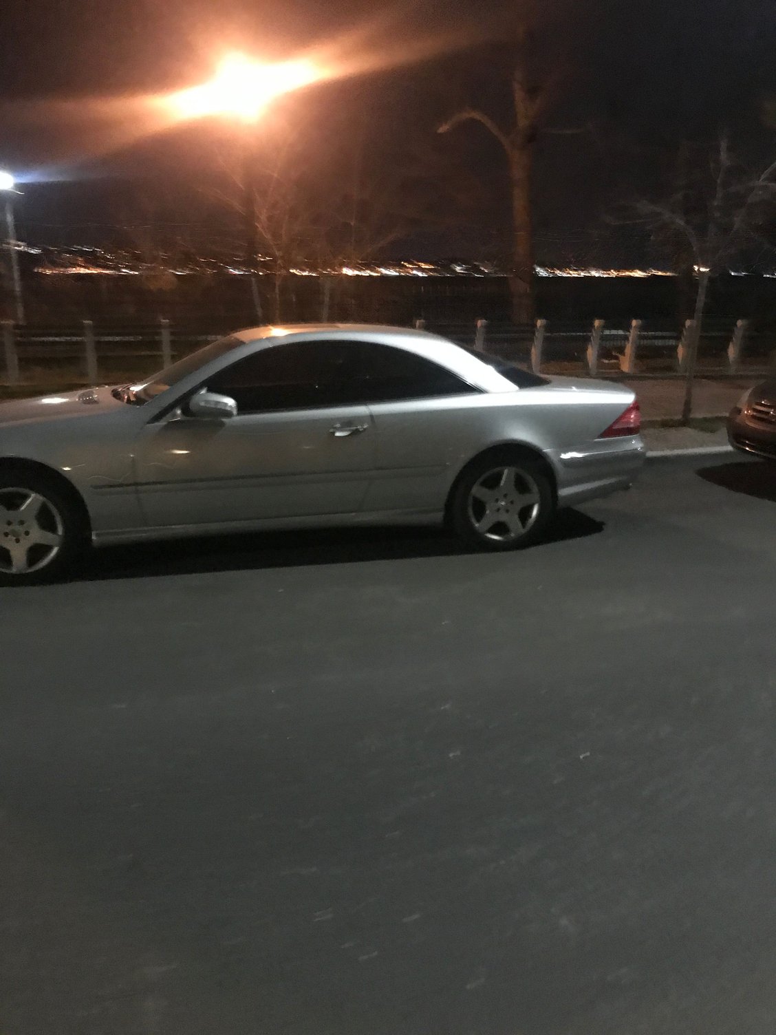

So I need new tires. But I'm not sure what to get. So the a dude at a tire shop told me pilot super sport 3. What's a little confusing are the sizes. Do I get the size on the door stickers or do I get a little bigger?? Do I get one size for the front and a difference size for the rear? Basically, am I sticking with stock or not?

Tusabes, I feel like you're secretly a MB mechanic trying find out how much we know on the forum. I have the amg badging and what looks like amg body kit. So I'm not sure if that's "sport". I will say these tires are huge. Are these the sport wheels? The wheels themselves have the amg etching on them.

Yes you have the Amg sport package 18 inch rims
correct oem size tires for these wheels are 245/45/18 front and 275/40/18 rear .
Many people put on the wrong size tires because smaller sizes are cheaper
