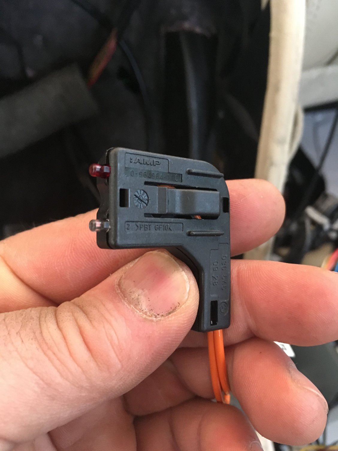

CL
this plug is connected nowhere
is this to amp ?

Originally Posted by renault12ts
Sorry, I can't help, I ditched the FO.
amp works
I tested it with the old command
and it doesn't require that plug
problem is the dam fiber optic decoder
my plug doesn't fit
even oem fiber doesn't fit in the holes
Old Jan 10, 2018 | 09:40 AM
renault12ts's Avatar
Joined: Oct 2010
Posts: 724
Likes: 41
From: UK
W215 CL500 2005
Yours isn't MOST. You have D2B.
http://www.mercupgrades.com/Mercedes...article-7.html

Old Jan 10, 2018 | 11:31 AM
pmercury's Avatar
member
iTrader: (2)
Joined: Oct 2016
Posts: 3,093
Likes: 807
CL
can you show me what box I should get ?
Old Jan 10, 2018 | 11:42 AM
pmercury's Avatar
member
iTrader: (2)
Joined: Oct 2016
Posts: 3,093
Likes: 807
CL
seems impossible
I will have to change the amp
https://mbworld.org/forums/c-class-w...onversion.html
