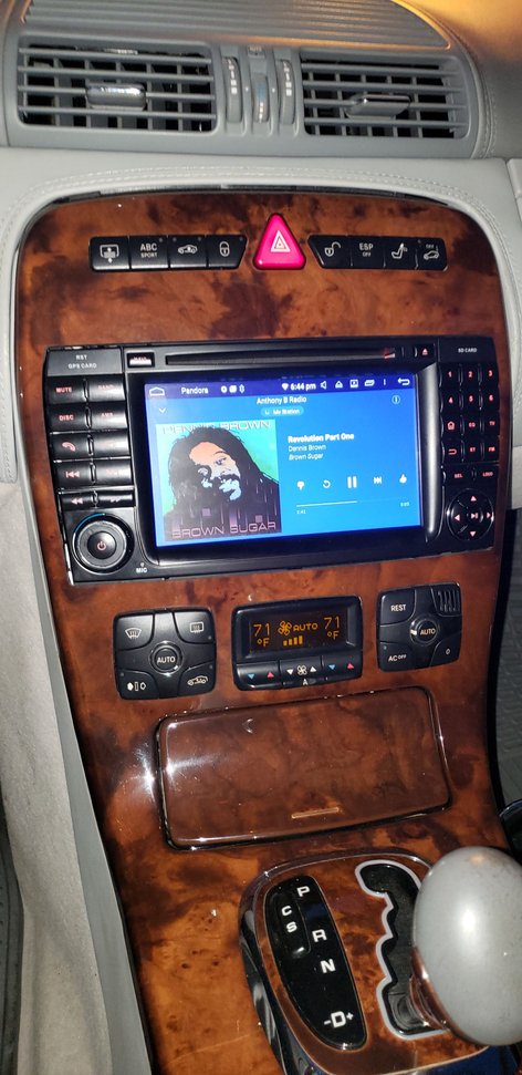

Originally Posted by wewmbw
Ok I have a 2006 CL500 I inherited last year that I decided to keep. Low miles only 7500. Love the car but would like to add bluetooth (Phone and Audio) and SAT radio. Found this video on another 2006 CL that removed the factory audio https://www.youtube.com/watch?v=OkQp9tW51RI .
My question is if I do the upgrade what effect will it have on the resale or collectible market if I decide to sell. Will not having the stock Audio affect the resale value?
T
his is my 2003 CL600

Originally Posted by MrTracy
T
Nice upgrade. I see you still have the Factory Bezel. Did you do the update yourself?
Old Oct 22, 2019 | 03:54 PM
MrTracy's Avatar
Joined: Dec 2007
Posts: 171
Likes: 26
From: Maryland
2007 S550 & 2009 CL63 AMG & 2009 BMW 328i Convertible
No I didn't. Its a Chinese Android. Perfect fit.

Thanks for the Input MrTracy. I really like the way your China Android looks. Updated but still keeping the stock bezel. Do the steering wheel buttons (Volume up down etc.) still work? Also does the radio channel still show up in the dash on the info display? I feel going that way would probably not affect the resale value or collect-ability market.
The bezel is not stock...it just looks that way. All the buttons are operative and the screen is a touch one.
Volume can be controlled and stations changed...but channels will not show in the dash.
The system can connect to your MOST optics with a box...not difficult.
I did away with the FO because the BOSE amp was dead. I placed an amp in the boot and ran cables from the head unit to the amp.
No steering wheel controls but it is doable. You will get a lot of heat from installers about the Chinese radios. Also no info on the dash.
The Bezel is stock my friend

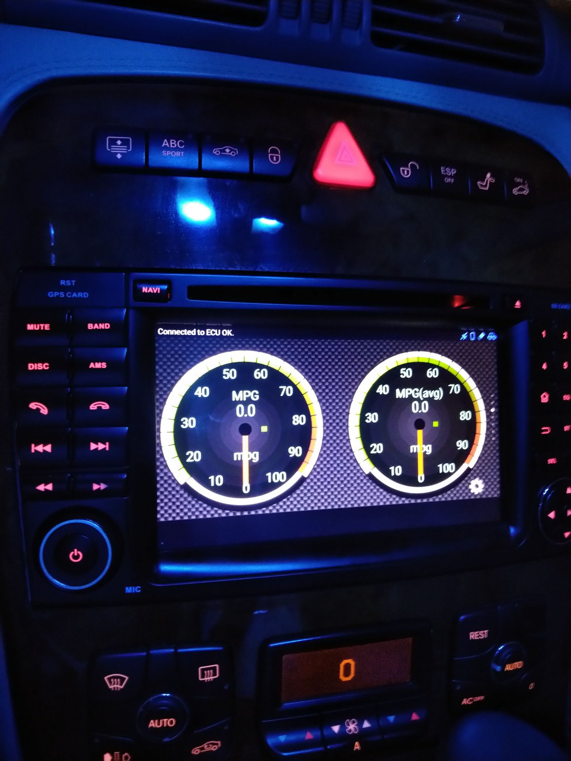

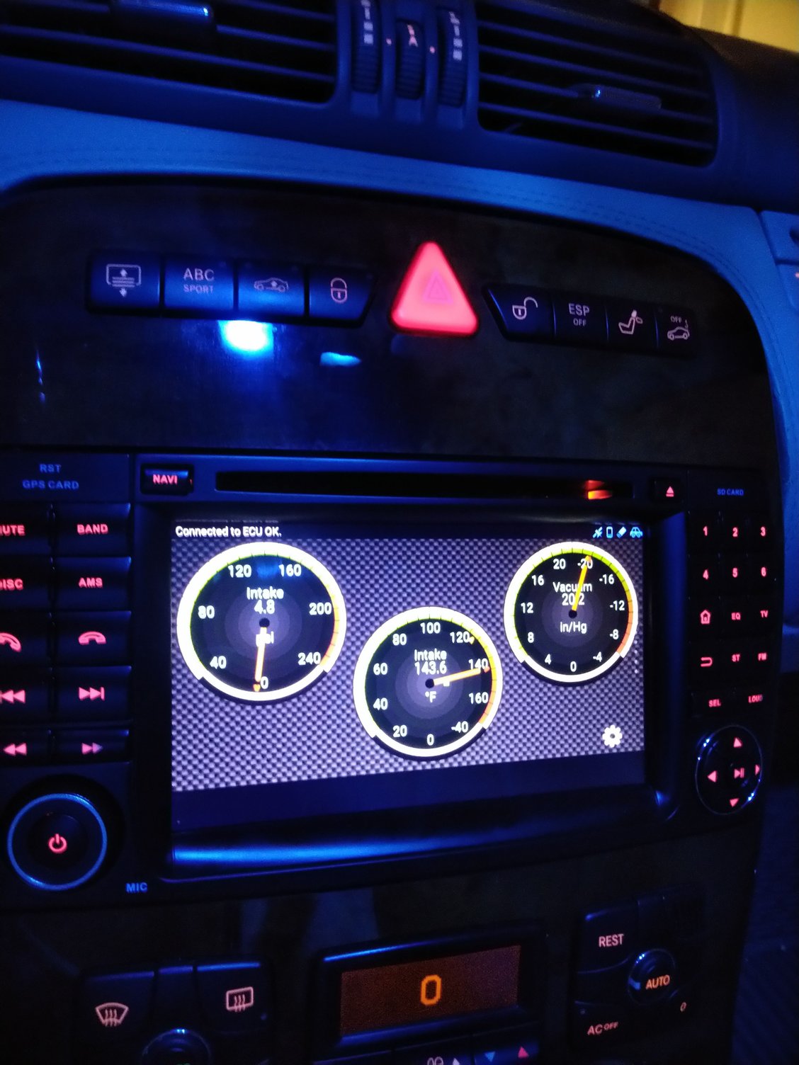

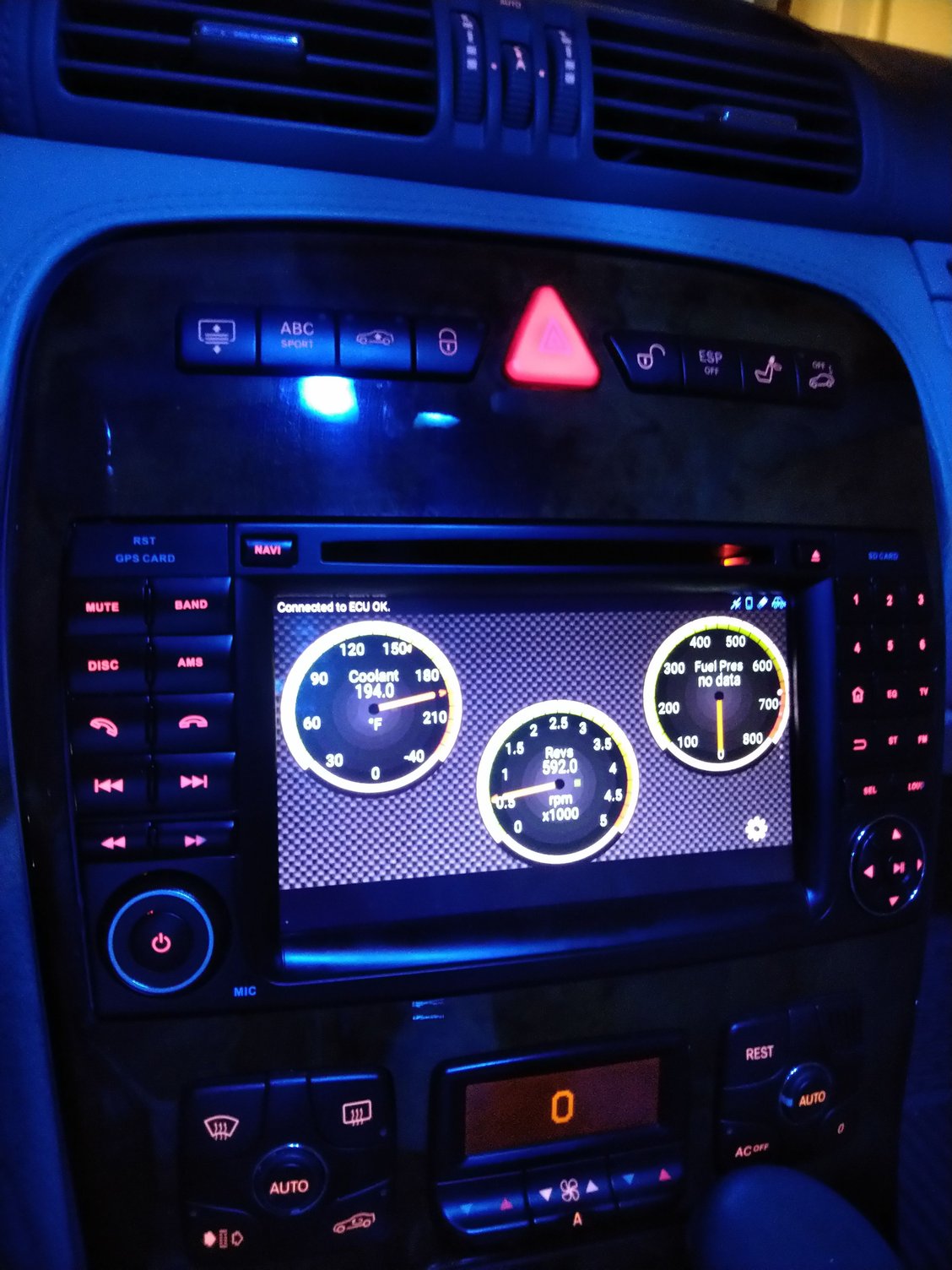

Old Nov 3, 2019 | 07:17 PM
tusabes's Avatar
Joined: Jan 2008
Posts: 6,151
Likes: 533
Mercedes
Those Chinese android units are the way to go because they look stock , give you Nav and dvd movie playback, Bluetooth audio etc . The build in obd monitor is way cool too and adds gauges !!
