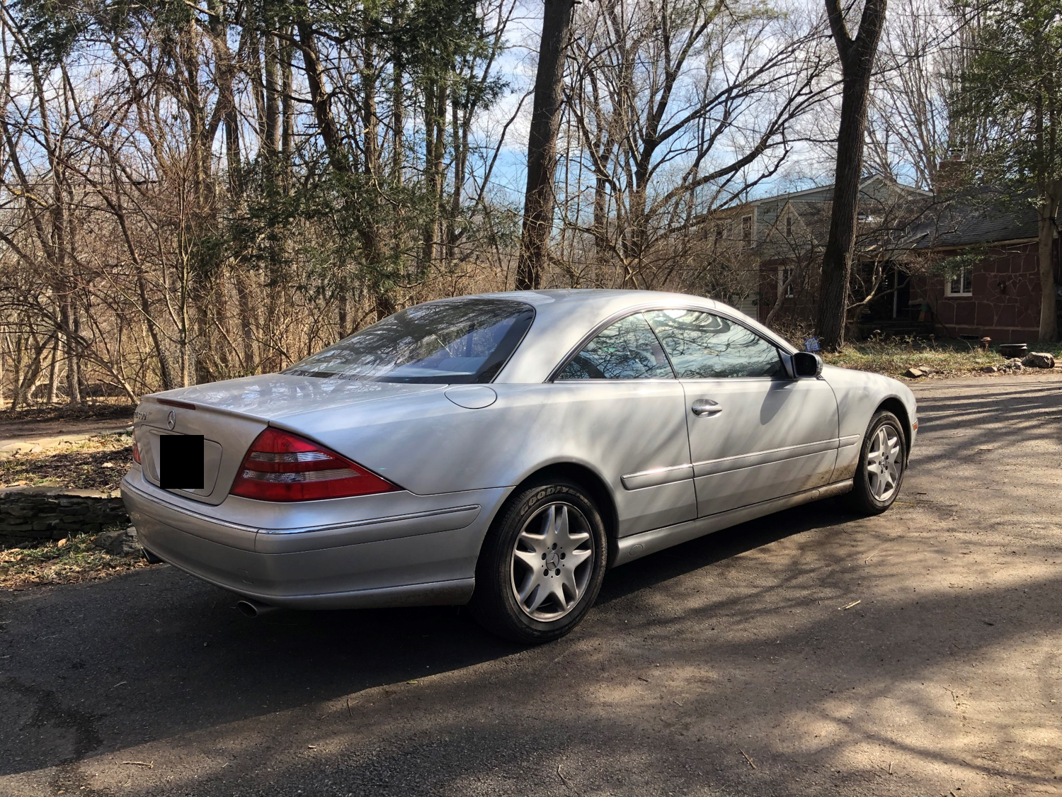

Hi all,
Sorry for the delay, ice-storm and all. In the end I did "buy" it, meaning it'll be something keep up to snuff for a while. As my FFinL said it's now my monkey and my circus to manage. Speaking of which, it looks like the ABC fluid is more than a bit old (less green and more brownish-green, like it's got sinusitis). So, first thing I've gotta do is find someone who can do a full flush on it. Otherwise, it just needs new tires and a decent once-over to buff out the scratches etc.
Anyhow, thanks to y'all for helping out with the decision. I'm sure I'll be back on here sooner than later! Pics attached.
