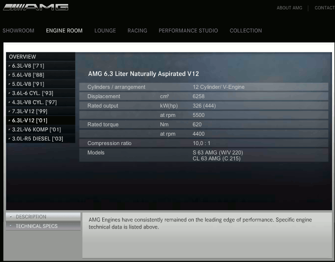

AKAIK:
The CL63 is a collectors item. It is an increased displacement 6.3 liter version of the 5.5 liter naturally aspirated V12 of the C215 CL before the facelift, which also brought the V12 twin turbo with 500Hp. There is also a limited run of 2001 S63 vehicles.
IMO
The CL63 is a collectors item because so little have been made (FWIW). It having 'extensive Renntech' modifications would make it a no-go for me as such cars should be kept in mint condition.
Your VIN output is rather strange. What do our russian friends say about the VIN? http://www.mbclub.ru/mb/vin/?lng=eng
More (limited) info:
http://www.supercars.net/garages/marcusmv3/126v2.html
http://en.wikipedia.org/wiki/Mercedes-Benz_CL-Class
And from the AMG website the attachment with a little official info.
There is one for sale here too: http://www.asv.nl/aanbod/detail/?097...E4CE9C5E74283/ My wallet itches every time I see it...

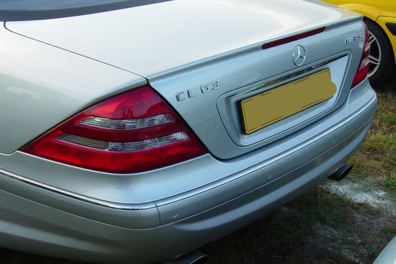

2009 SL63 AMG
Those were just a few photos of a CL63 I found while browsing some time back. ds. If you can, is there a link to dealer's website or a photo of the motor you can post. I don't believe RennTech offered motor rebuilds for the M137 V12; in fact, only Brabus (according to my recollection) offered a reputable motor upgrade with the M137. The top trim was the 6.7 Litre S form, which yieled 475 hp. Good luck with the sale, for if it is original, then you have quite an exclusive automobile on your hands.
