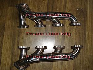

just got em from ebay for $1200 brand new , do you guys think i got a good deal???? it's for my 03 cl55 i already have the eisenmann exhaust do u think will sound better with the headers ???

I heard they r very good quality ,my friend bought them for his e55 and it sounds a lot deeper and more power

To small to help with any decent power gains.. You may get a little more sound but your four cats control most the sound.. If you want sounds, then mufflers and add race cats..
I did the opposite.. I have large long tube headers, race cats and stock mufflers and resonators.. Make huge power, great sound under throttle and nice and quiet at cruise!

as exotic said the gains will be very minimal

I would hardly say minimal gains from these. I gained 42whp from these alone.Bolt on same, day before and after dyno. Most people who knock these should try them first..

I recently purchased and returned a set of PLM 63 headers that were on ebay.
These were without doubt the worst designed headers that i have ever seen, obviously designed for ease of manufactured with no consideration to balanced ports, back pressure or air flow. The port entries were actually smaller than the OEM manifolds.
The ebay picture showed headers which appeared to be a reasonable design but they were not the ones I received. I later found out the picture was of the 55 headers.
