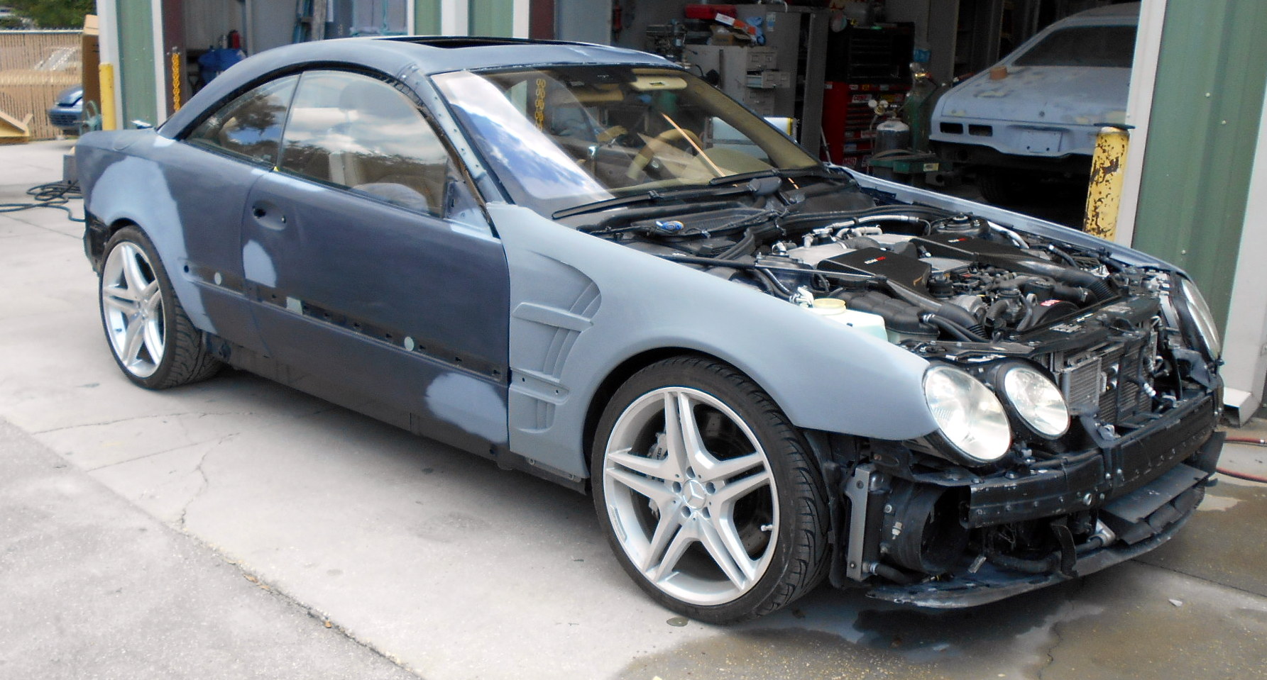

My '05 CL65 had no body damage. However there were rock *****s/road rash upfront from its first owner (I'm 2nd), the clear was starting to let loose at some edges, and at various places the paint was showing imperfections.
It came from Mercedes with in special order Midnight Blue - a $4000 extra charge. I suspect it may be the only one made in that color.
The picture below is how it looked prior to the work (not body damage):

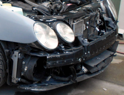

I had a custom car shop disassemble the body except the doors to avoid hanging issues on reinstallation, remove all molding (all window rubber molding to be replaced), all badges and all trim removed. I also ordered vented fenders. They took a significant amount of reworking to make the perfect as the molding were not good. I also had them slightly stretch out the rear fenders and the rear fender lips rolled under to between allow the 20 inch rims a bit of room.
After removal each body piece was taken down nearly to the primer and in some areas to the primer where the primer was letting go, checking, or appearing to start to bubble. Removing the body panels allowed address joining areas as that is where most issues likely would be, plus it avoided any paint puddling.
When each part was right, it was then sprayed, allowed to harden 3 to 4 days, wet sanded down, sprayed again, wet sanded down, and then again, with this repeated for 3 coats of clear in the same process. This 3 week painting process should produce a superior result to factory in durability without piling on a lot of paint. Part of the contract was that all sanding would be by hand - no power sanders or polishers allowed. Between the hand-labor body and paint work, no-power-tools limitation, plus the fender and reworking it plus ultimately finding rather expensive
Mercedes molding, this was not an inexpensive undertaking.
I had the Renntech carbon fiber motor cover removed to avoid damage to it during the work. The pix shows the Renntech air boxes.
The finished body and paint work. The front grill also was blackened other than the circled triple star left in chrome. The Mercedes hood badge replaced with an AMG badge. The blue is darker than appearing in the 2 photos below.
The front fender - prior to removing it and reworking it still again as the fender curve still had imperfections.
Despite my repeatedly instructing NOT to put any badges back on it, some hourly grunt at the shop found the new badging I had in the trunk and put on the V12 BiTurbo badging (and doing so badly). This badging in the photo came off when the fenders removed and again stripped and reworked. A 2nd new set of badging ordered (OEM) and the car currently debadged until it is trailers back from Renntech. I do not put pointless miles on it. It is a special occasions vehicle.
The shop owner expressed some regrets of taking the job as I held him to the standard of "perfect" - which he promised. It doesn't usually take 3 months to do a car requiring no body repairs.
It is currently debadged, but new badges including reinstalling the Renntech metal badges. It is a Renntech CL65 - not just Renntech software/programming - and currently is at Renntech's Lake Park FL locale for regular servicing, flushing the trans, replacing motor and transmission mounts, a new radiator(inspection showed the prior own had the radiator repaired and it seems best to just put in an new one), hoses, oil change, some other matters, checking it all out and with some additional upgrading in the works.

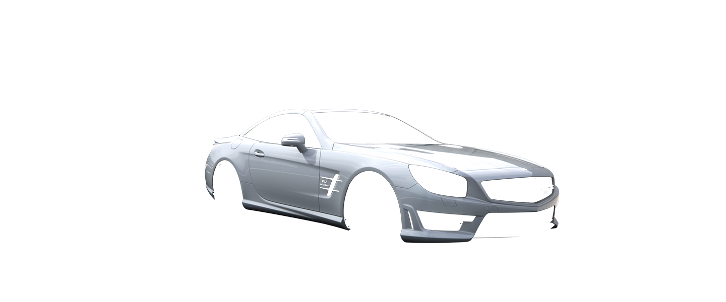

Would you say the SL65 has ricer looking fenders?
Its a matter of what a person wants of course and the personality being portrayed. Mercedes puts vented fenders on most their performance oriented models. I did not see any wide body kits I liked or would have opted for one. But in my opinion the CL65 is boring looking from the side plus wish the rear was not so square. Nothing I could do about the rear. In my opinion, the W215 CL65 was a marketing failure for 3 reasons, one of which is it did not look like a $180k car nor look particularly fast either.
They are true vents, not faux, so will serve some function in allowing some heat out of the motor compartment without doing something I would see as cheesy like putting louvers on the hood. It get HOT here in the summer.
