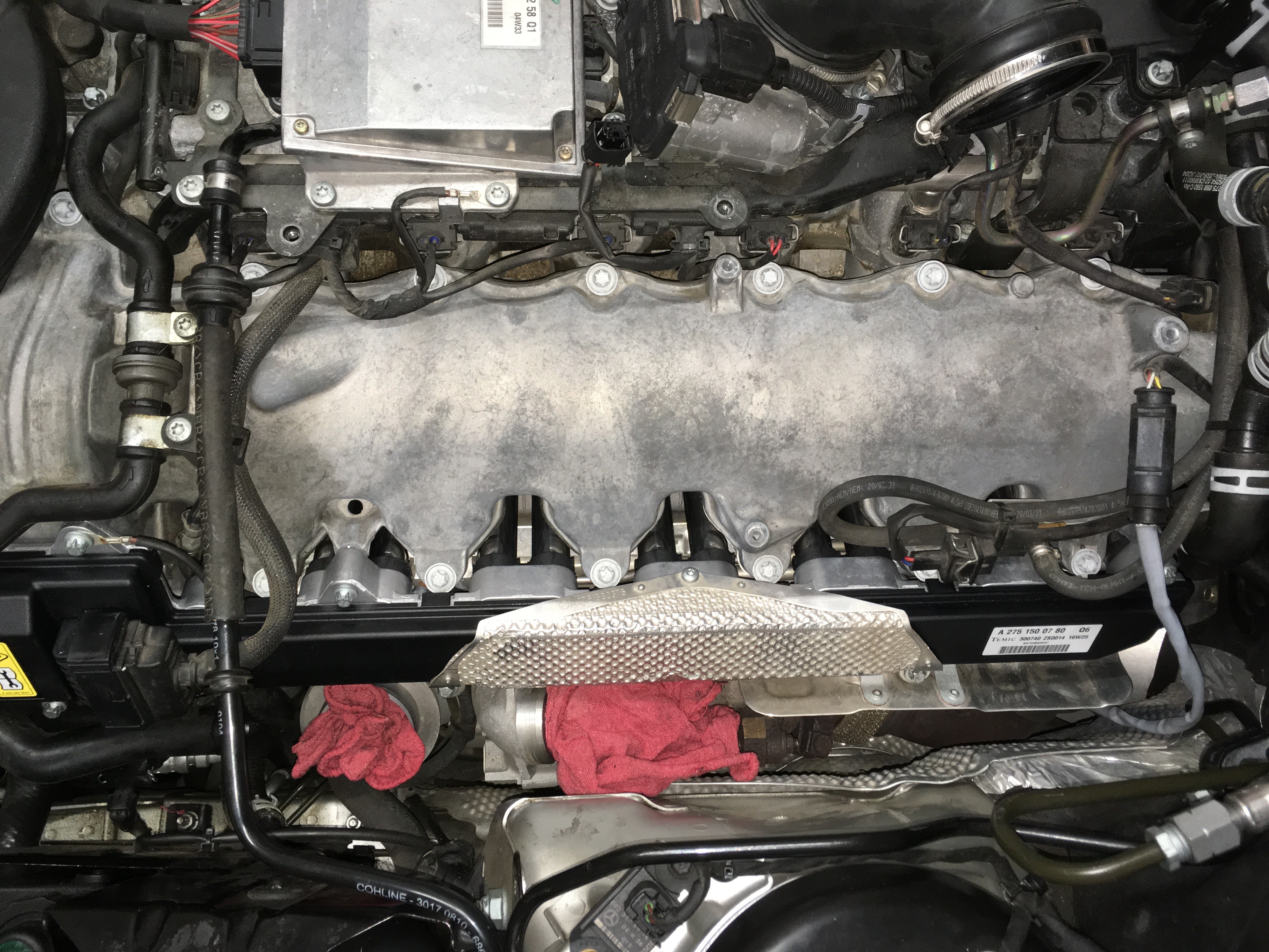

Old Jun 20, 2017 | 11:25 AM
Geraldius's Avatar
Joined: Apr 2011
Posts: 130
Likes: 53
From: NC
'15 GLK350, '05 CL65 AMG, '04 C320 4matic
Coil pack dies
So the saga continues.
I was getting on the throttle from a slow speed ... it started to accelerate, then POP! and the check engine light comes on and little power. Limped home and read misfire on cylinders 7-12.
Tests indicate the left side coil pack is shorted. Regardless of whether it was bad, I had to severely damage it to remove it -- several coils were seized up on the plugs and pulled out of the coil pack while removing. It looks like it had never been off the car before. I discovered white corrosion on several of the plugs, which appear to be original.
Ive got a new set of plugs on order and a new left side coil pack in hand. But I'm afraid to try to change the plugs on the right hand side as it risks damaging the coil pack to get at them. Should I just leave that side alone? Plugs were all in great condition and burning clean on the left side; they just had the corrosion around the bases. Looks like water was sitting in the pockets for a long time. I'm thinking someone must have washed the engine down and left it wet. There's no signs of leakage anywhere on the motor.

I would say don't delay the inevitable. You got a good price on the car, just replace the dated 13yr old coils and plugs at the same time and move forward. I highly doubt one side would fail and the other would live much longer.
Yeah, that's possibly what might happen. Still, I'd like to be able to remove the other coil pack without breaking it. I wonder if dousing the plugs with WD40 would help it to let go.
Also, the replacement coil packs are a newer part number -- and cost more. Can't get the originals any more. Wonder if there's any performance difference...

Old Jun 22, 2017 | 10:15 AM
Geraldius's Avatar
Joined: Apr 2011
Posts: 130
Likes: 53
From: NC
On the road again
I got the new left bank coil pack and plugs installed last night, and that appears to have fixed it! Coils went in much easier than they came out. A bit of dielectric grease on all the boots helped, and it should prevent them from being stuck next time the coil pack needs to be removed.
I'm a bit afraid to get on it very hard since that is what killed it last time. I've still got to change out the right side plugs and do the B service, which is a few days overdue. Going to take it easy on the car until all that's done.
The maintenance schedule gives a mileage or time limit for certain service items. Well the spark plugs looked like they were all burning clean and are well below the mileage limit, but they are supposed to be changed at 12 years regardless. This is 12 years. About half of the plugs I removed had corrosion around the bases. I can see where you'd want to change plugs after a certain amount of time just for issues like this even if they are working fine. Wouldn't want to have them get frozen into the head from being in there too long.
Attached Thumbnails My '05 CL65-coilpack_02.jpg   My '05 CL65-coilpack_03.jpg   My '05 CL65-coilpack_04.jpg   My '05 CL65-plugs_01.jpg
If you didn't bleed your intercooler system it will be needed, it is very easy to have air trapped in which will allow the car to heat soak much easier. Its a bit of a process that doesn't always work out successfully at home and requires a special vaccum/suction to get out all the trapped air. For the future, when you do the other side coil/plugs only unmount the intercooler, but leave the hoses on. They can be tied or supported out of the way to work without dealing with a loss of coolant on the charged system.
Thanks, I did start out that way but got fed up with fighting to work around it. Then I opened the pressure cap to have a look and found that the level was already below the top of the hoses. Didn't spill a drop. But of course I'm going to have to top it off anyway as it turns out. Looks easy enough. There are air bleed fittings at the high points of the pipes that I can connect a mityvac to. (Just FYI, I'm a highly experienced mechanic with a fairly well equipped shop at home).
