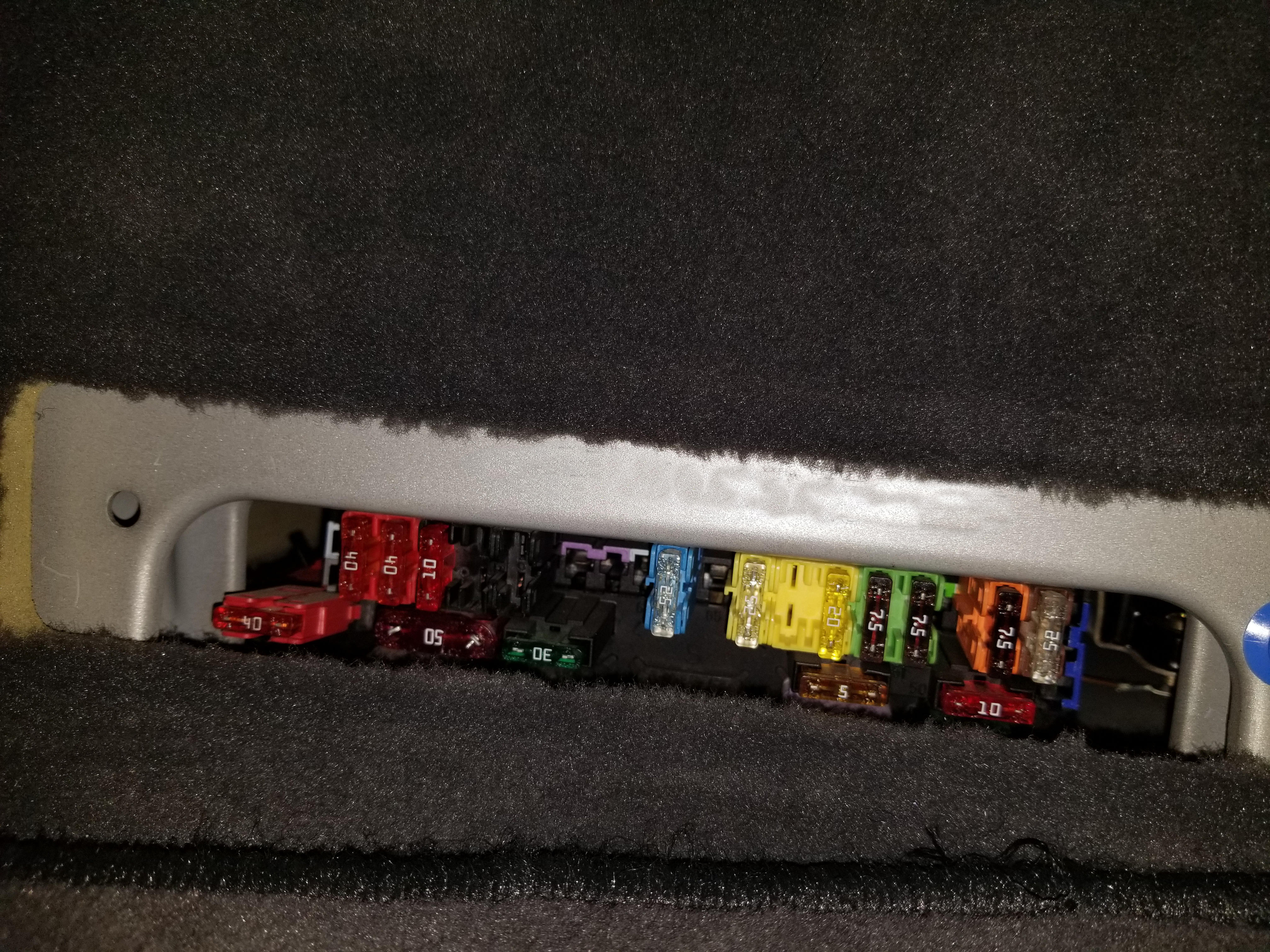

I don't see a fuse that says F62 I provided a pic of the fuses let me know witch one it is to pull out to reset the trunk hydrolic pump
https://mbworld.org/forums/attachmen...stc=1&d=150282 here is the link let me know whatfuse it is thanks

It is the yellow 20A fuse, 5th one in from the right side, (or 6th if you count the missing one where there is a space).
I tried pulling the 20 A fuse but I reinserted it after like 20 seconds should retry it again? or is there another problem with the trunk?
