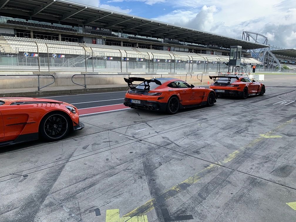

Well, don't know where to start. From reading and learning about cars over many years and doing my due diligence before buying a new car, and I've been to the factory multiple times. With AMG you can also participate at the AMG Experience events where you learn about the cars and drive them to compare. Just came back from another one in Germany. This was my 4th one. Drove the new GT 63 coupe and I've driven everything else including the GT Black Series at previous events. Got to haul the BS around the Nürburgring a couple of years ago and did a winter event last year drifting around in the snow, although they had to make snow as the weather didn't play along, but it was still fun. We drove the A45S at that event on the skid pad. That was quite a bit of fun, too, but trying to drift it otherwise was a real pain due to its architecture. Didn't like it.
