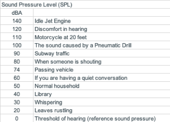

82dbA for new passenger vehicle up to 2026 just below NYS. I don't have a db meter but I'll bet my CLE53 exhaust is much quieter. The engine itself at WOT is LOUDER!
