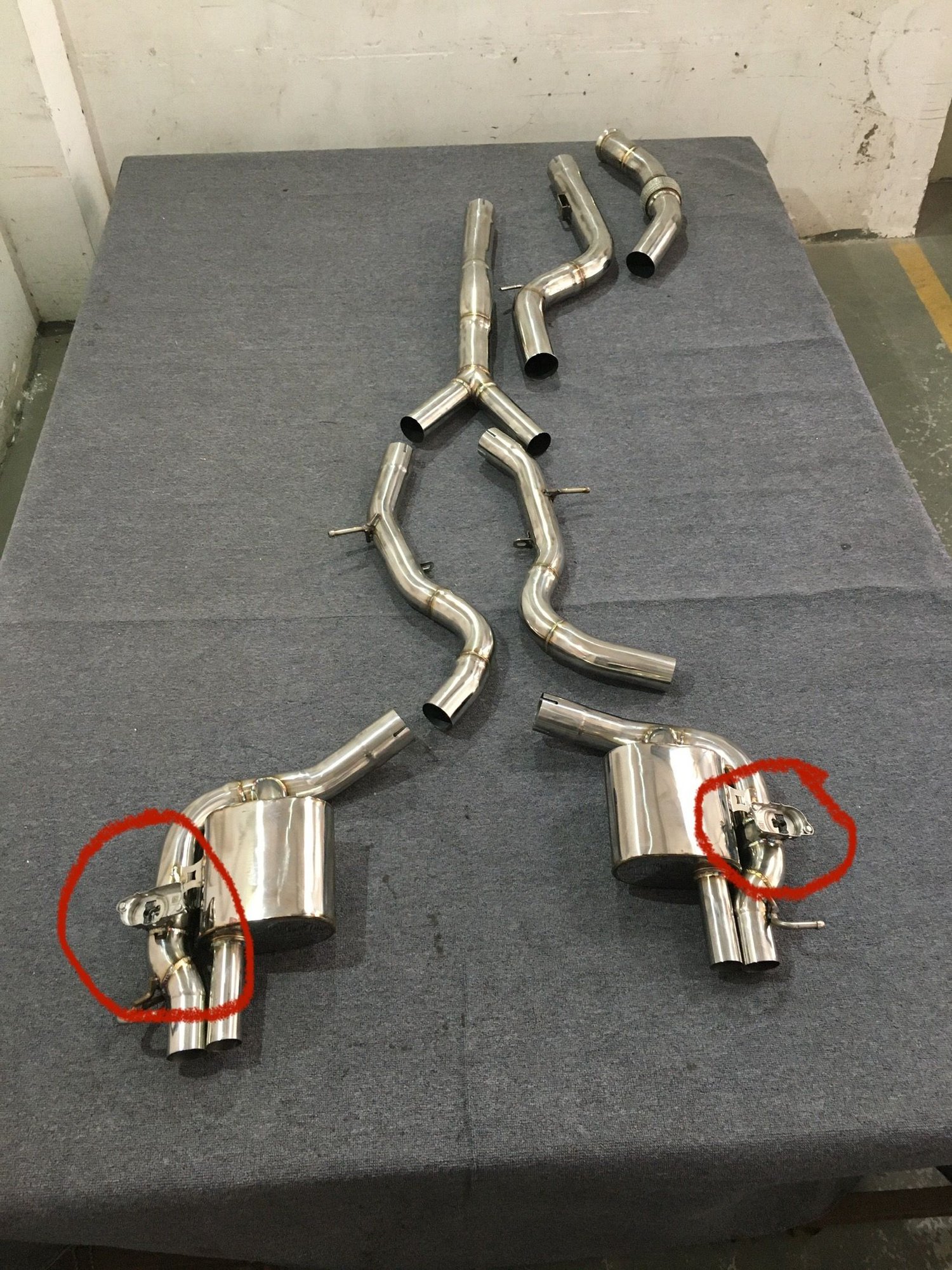

Installed my RES exhaust today. Car sounds great but dealing with a slight headache in a pair of DTCs triggering a CEL:
https://www.google.com/search?q=Merc...ble+code+P13C2
https://www.google.com/search?q=Merc...ble+code+P1404
I ordered the RES exhaust that comes with brackets for the OEM valve motors. We installed the motors into the new brackets, and the actuation IS working, but the CEL comes on all the same. Few cons here is remote start now will not work as the car “fails” the start up checklist.
if anyone has any ideas I would love the assist.
TLDR: New catback exhaust is on the car, the OEM valve controller/actuator was removed from the OEM mufflers and installed onto the new mufflers. Actuation from the steering wheel exhaust button is seemingly working, but the DTCs are still triggered.
picture: res exhaust with the special fitted brackets for the OEM valves installed actuator

Hey , man contact the RES Henry they are quite responsive I believe , Could be one of the flaps i getting blocked , try to remove flap engines and start the car with them hanging on the cables .

Thanks. Contacted RES Henry and he let me know that my situation with the DTC is the first he’s heard of which is actually encouraging to me. The car is now back at the shop and my guy is working on setting the valves right to stop the DTCs. I will keep you guys posted.

So had the car in the shop today and they tried "setting" the valve actuation point to halfway open to match the OEM spec of the valves when the car is off.
Still getting the DTCs on.
I reached out to a forum member who had a similar issue installing an IPE Valved Catback on his GLE 53 and he said this:
Hi. Actually there is no way around this at this time. The exhaust manufacturers say this will fit the new year mercedes benz models. But actually nobody tested them besides like you and me. And they think that a 2022 is the same as a 2024 and it clearly is not. So it sucks. My IPE exhaust is for sale just sitting there. I suggest checking your code what you have showing up. But as soon as you see flap malfunction or actuataor anything like that then yes it is totally because of the flaps. I even went to the dealer 2 times paid $$$ for them to force to learn the flaps and I made it 100 miles that time before the car got a check engine, my burbles stopped and its pretty much in limp mode in sport+.
For anyone thinking about going the RES route, I would take a beat for now....
The guy I have the car with right now is going to give it one last try tomorrow. If not, I am going to look to re-install the OEM exhaust. Last thing I want to deal with is limp mode.

Update: we finally found the correct valve resting points and the system is installed and trouble code free.
The mistake we made was making both the left & right mufflers start at the same valve position. The left muffler is actually much bigger than the right muffler and so even with the new RES system (where both mufflers are the same size), the left mufflers' valve must be more open than the right mufflers valve to match the cars expectations.
RES has been very supportive through the process as well. The car sounds great and will take more exhaust clips shortly.
Initial impressions:
- Car is much more audible in S+. Exhaust note sounds great, is the right amount of loud, and very satisfying in spirited driving.
- Plenty quiet in comfort mode with valves closed.
- BURBLES are much more pronounced and loud.
So happy you fixed that bro!! I just had my RES installed last week. Someone else told me to make sure the valve positions were memorized. Saved me a headache!
