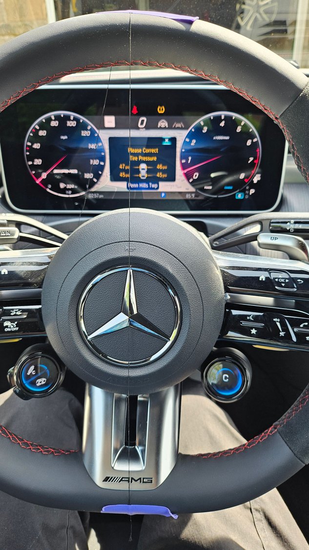

Whenever I get a new car, I apply an index stripe to the top dead (12:00) position. This strip is essential for the track and applies a bit of a aesthetic flair as well.
If you are planning to do this, I have some tips from experience that might help. It's not rocket surgery!

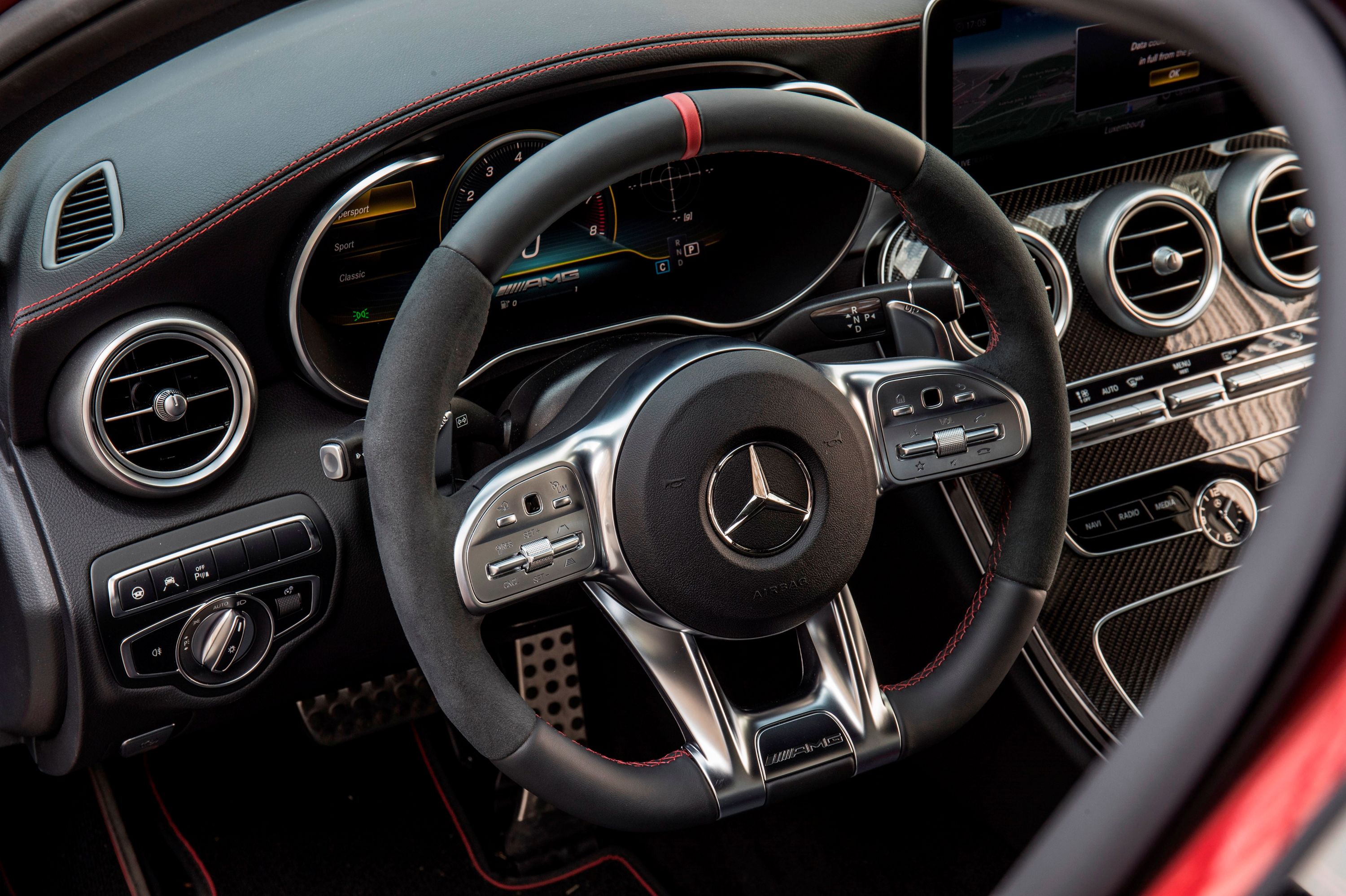

Hmmm. I never paid attention to it, so the CLE 53 doesn't have it, period. Wonder if they reserved it for the CLE 63 whenever that comes out.
Old May 5, 2025 | 06:15 PM
W205C43PFL's Avatar
Posts: 32,224
Likes: 6,283
What is even more strange is the W205 C 43 has it for example: https://static0.carbuzzimages.com/wo...800/508887.jpg
But the W206 C 43 no longer gets it.
Old May 5, 2025 | 06:17 PM
W205C43PFL's Avatar
Posts: 32,224
Likes: 6,283
Okay so the W206 C 63 S E Performance also doesn't have it https://i.ytimg.com/vi/7qrT3118Nb0/maxresdefault.jpg
Basically they removed it for some reason.

I have the same wheel ,what did you use for the strip and how did you apply it , thanks in advance
Old May 7, 2025 | 02:11 AM
ghgoldberg's Avatar
Joined: Feb 2025
Posts: 89
Likes: 24
From: Pittsburgh, PA USA
2025 AMG CLE53 Cabriolet
1. Park with the car heading zero degrees and the steering wheel centered.
2. Clean the top of the wheel with a quick wipe of isopropyl alcohol.
​​3. Tape a thread from the bottom of the wheel, thru the center of the wheel, and around the top of the wheel. Verify that it is centered. (Easy to do with Mercedes!)
4. Dab a teeny tiny (pardon the technical jargon) of superglue on the threads about +/- 1/2" (12 mm) each side of the line.
5. Cut a foot or two of Mitchell's abrasive cord. (You can substitute a fine triangular jewelers file, or if you pm me your address, I send ya a few feet of Mitchell's.)
6. File a groove in the leather +/- 1/8" (say 3-4 mm) from the line all around. Don't worry about the bottom where the threads are. My grooves taper off there, anyhow the superglue will prevnt the threads from unraveling in any event. Lightly scuff between the grooves with 400 sandpaper.
7. Mask outboard of each groove.
8. With an artist's brush, apply a couple of coats of red rustoleum. I have used rustoleum in the past to good effect. (I didn't here, and wish that I had. Rustoleum is slow drying so it dries nice and smooth. I thought that I would apply the "right" material this time, so I got some leather paint, but it is fast drying so requires several coats with sanding in between to get it smooth.)
9. Optionally, you can apply a thin coat of clear or black in the grooves.
