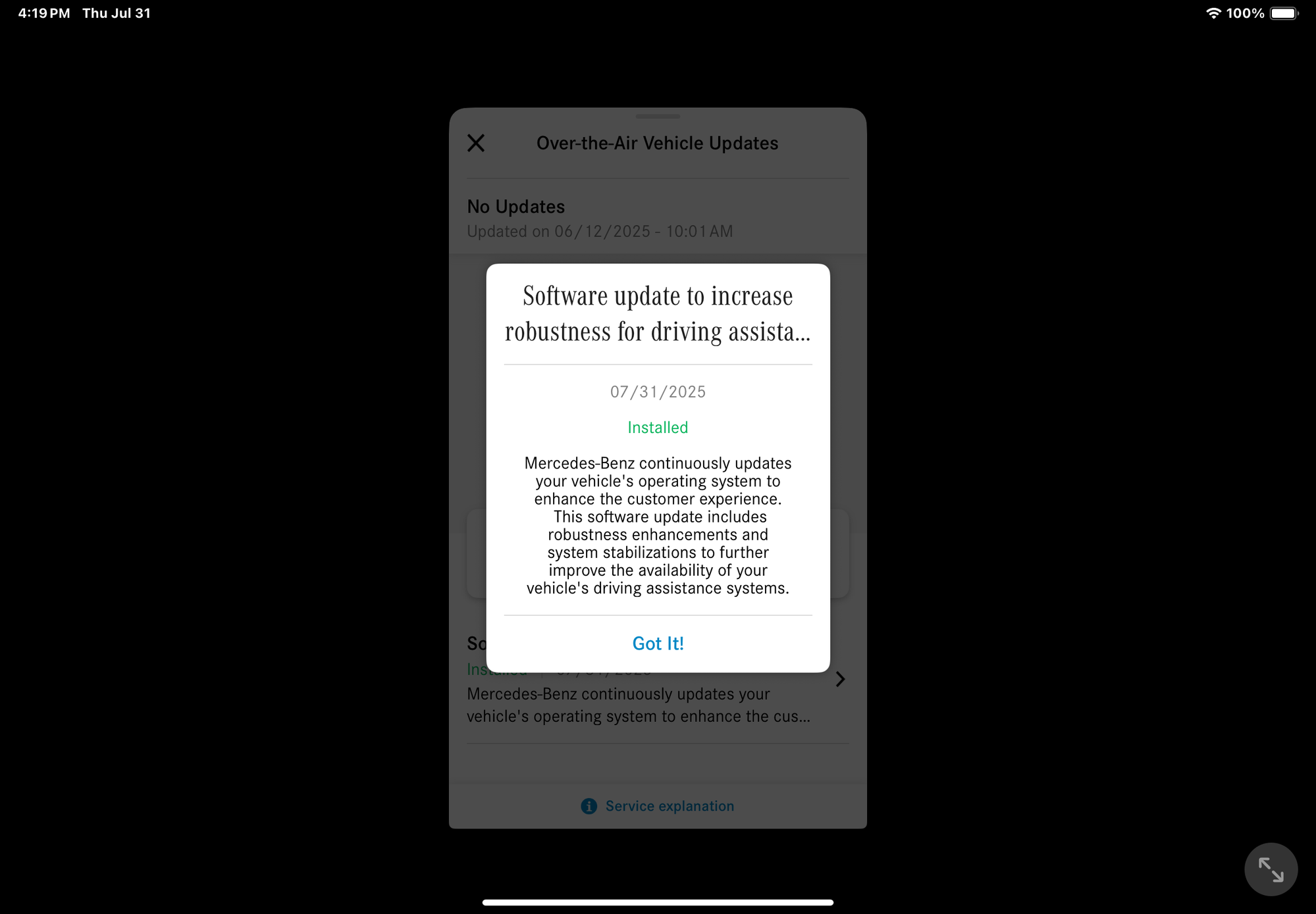

System update OTA today

7/31 OTA Update errors
2025 CLE53 Cabriolet
The first four starts after the update resulted in all warning lights and the seat belt beeper staying on.
In addition, various false error messages appeared and reappeared after clearing.
Such as;
"Danger of rolling..." when in park with the parking brake set.
Just about every safety system; ABS, Collision detection reported as failed...
"Do not move transmission..."
"Seat belt chime" not quite continuous, but the breaks in it made little sense.
I decided to go get lunch and stop for gas on the way.
Checking to make sure the parking brake released and set, also that the transmission shifted properly.
When I broke the seal on the gas cap, the seat belt chime turned off.
The next start behaved normally.
Two minutes later the "Check engine" light came on.
Sho nuff, when I checked, there was an engine.
No errors logged in the service screen.
Now when I press either rear window switch, all four windows go up and down.
After putting the top down, all four windows go up.
Now if only pothole detection would detect potholes and not smooth road.
Stay tuned for further adventures in computer and CAN bus land.

Further adventures in CAN bus land
Such as;
A few days later, I loosened the gas cap and reseated it. Twice.
Ate lunch. On restarting, the check engine light went out.
/End of software upgrade/

Yes.
i got a message on the center screen.
It said that;
An over the air update had been downloaded and was ready to install.
Dated 7/31/25.
I must close the windows and top.
Turn the engine off.
Transmission in Park
Parking brake on.
Exit the vehicle.
Lock it.
It would take some time.
Pick a time to install.
I picked a time about 5 minutes in the future.
(This is all from memory.)
Version E270.1-5683 was installed.
I didn't use the car for about 30 hours.
That is when my adventure in flashing lights and bugs began.

I had an OTA note on my display this Sat.
Today it installed after parking my 53 and returning in about 45 Min.
According to my phone app. it's an update to "increase robustness of enhancements and system stabilizations which improves driving assistance systems driving".
I'm not sure how to identify the OTA in my system ID.
Further my phone app tells me that a previous OTA (02/12//2025) for my communication module was installed.
I never got any messages of that, but my phone app just informed me of it.
Not sure how those "enhancements" come to play, but no hick -ups so far.
