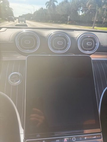

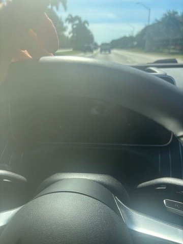

Drove my wife to a surgery center for a minor procedure this morning.
Everything was working fine in the car.
Dropped her off and went back to the car and started it.
Both screens were completely black. The NAV screen periodically would flash on but to a screen of white and then go back to black.
Speakers were emitting static pops every so often.
Sorry for the quality of photos. Wanted to capture them quickly to show it to the dealer.

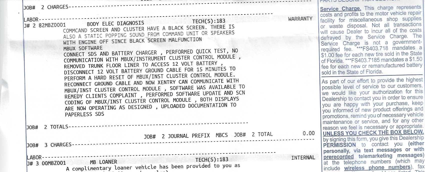

Performed Hard reset. Software update. See attachment

SA said he’s had a lot of C’s & CLE’s coming in for this. Thus, they are quite familiar with the issue and the repair process.

Initially, the SA said that an OTA update somehow corrupted some communication between 2 units
in the car. I don't know. I have to take him at his word. So, as you can see, there was a software update performed to remedy the issue.
I asked what happens if I am out of warranty and this occurs again whereby MB sends out an OTA update and it screws everything up again.
He told me they would take care of it.
We shall see.
