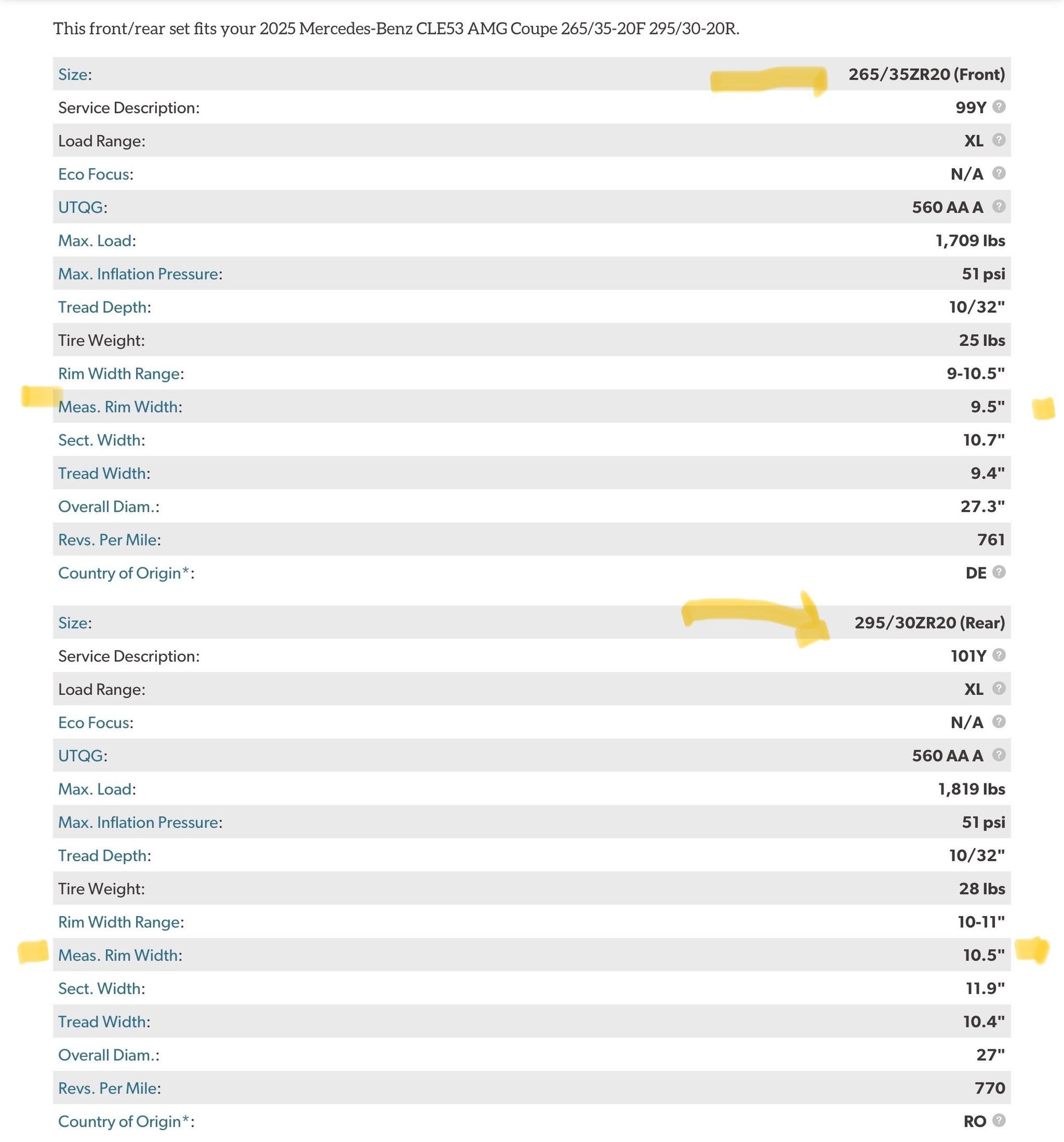

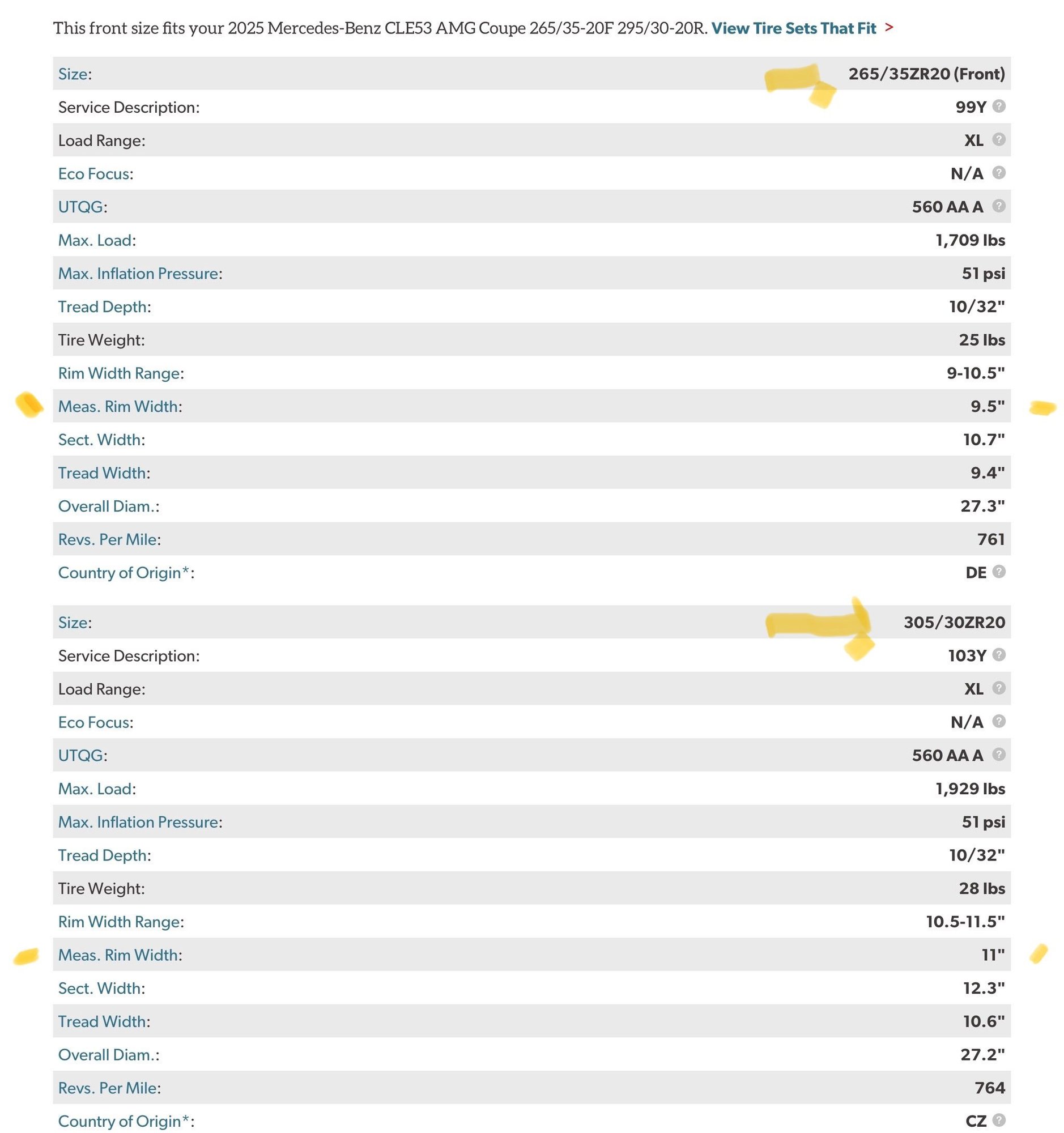

I don’t know why MB installed the 295 v 305. See attached screenshots of Tire Rack specifications of the two set ups: 265 with 295 and 265 with 305. The measured rim widths for the rear indicate the 305 tire sits better on an 11-inch wheel.
I am just evaluating the all season options at this time and will determine final sizing when ready. I too don’t like deviating from factory dimensions.
Thank you posting this - it’s helpful. I didn’t realize or appreciate this rim size difference. FWIW, when I went to the dealer to do the tire swap, they said they can only order tires that are “approved” via their internal MB system. As of November 2025, Mercedes only included the stock Michelin Sport S 5 and the all seasons weren’t “approved” or considered “OEM equipment”. That said, they agreed if I bought the tires from tire rack that were the same size of the stock tires, then they’d install them, which is what I did.
Surprised there is this discrepancy. The 295 appears to be “too small”, but I don’t have a sense whether it’s a serious issue. My car drives great on these 295s, so I don’t have a performance issue at low or high speeds

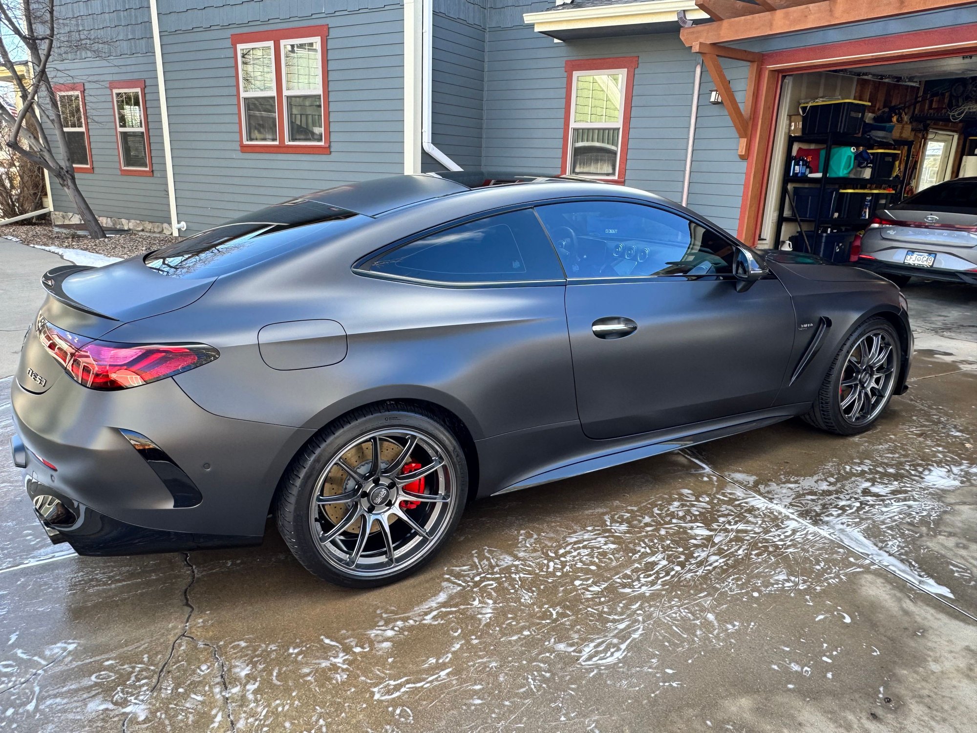

I have aftermarket OZ racing 20" wheels, with Michelin Pilot sport All season 4 tires. Drives well in the Colorado snow.

Looks great.

Looks good. Tint those windows!
