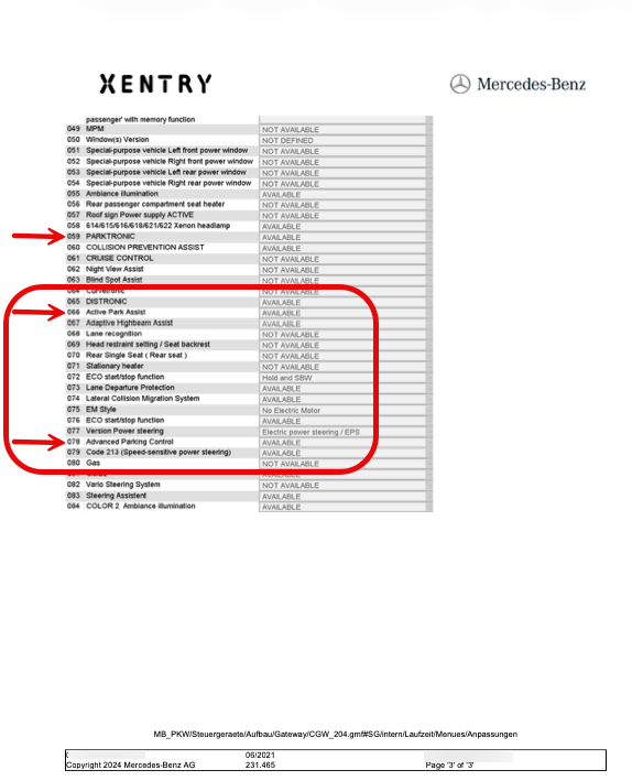

@MHBLAW If you are new to mercedes, the first thing you should get is a MB specific scanner. A popular one is the LAUNCH Creader Elite 2.0 BENZ. That will let you code out features you don’t want (such as disabling the START/STOP), change the limitations some have (such as top speed), and add some you don’t have (such as activating adaptive brake lights). Eventually, you will want to get XENTRY, Mercedes official diagnostics system, for serious DIY.
I think you can disable the P indicator with LAUNCH. It would probably be a change in the Instrument Cluster (IC) module. I want to say the option is Active Parking Assist, but I could be confusing that with the proximity alerts that you are about to hit something when parking. Next time I get a chance, I will look. But it’s likely to be a while.

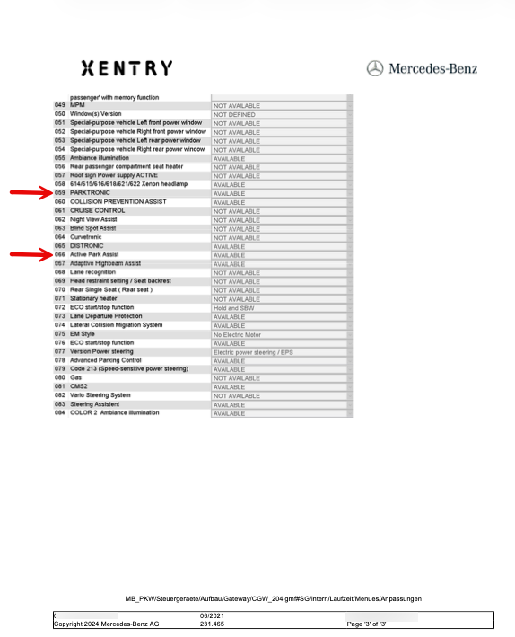

Actually, the coding to disable Active Parking Assist is in the Central Gateway (CGW) module. I’ve not tried it, but now I know where to look. (NOTE: This is why you will want XENTRY, as well.) PARKTRONIC is the feature that sounds an alarm when parking and getting close to an object. Also, the attached page is 1 out of 3 pages of configuration options. Some are dependent on hardware and simply activating them in the software will not work.
XENTRY Central Gateway Printout

Not sure if I would have to change both 066 and 078 to NOT AVAILABLE to eliminate the P. Sometimes you need to make changes in more than one location.
