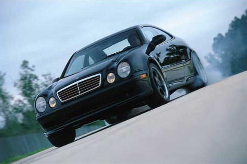

Originally Posted by 55 ON IT
You know I was about to blast your a$$ if you didn't edit your original post! LOL! Just playin man! I know the v12 is no where near ideal for a small car, but it's not going in my car either.
If I were you I would just get an w211 e55. I'm just lucky enough to have access to one whenever I please. Like the w208 CLK55, in my opinion the w211 E55 is a classic in the making.
I'm with you on that one, they (w208/w211) just look good from every angle.
So instead of putting in an N/A V12 like Renntech CLK GTX, would it be possible fit a V12TT into the w208 engine bay?
