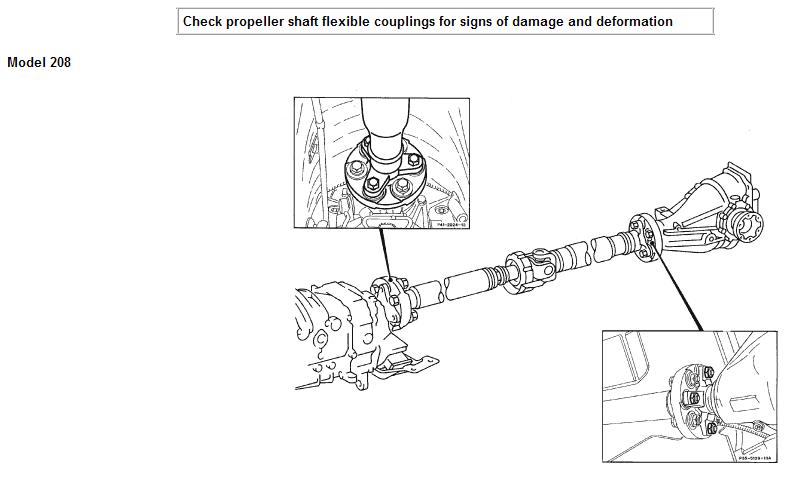

Ok i have a 1998 clk320 with about 105k miles on it. I have done all of the schedulled maintinance and have never had a problem with the car. This morning i was sitting in my car in park and i noticed a dull clunking sound that was clunking in tune with the revolutions of the engine. At first i thought it was something in the engine, but when i put it up on my lift I could feel the clunk in the rear axle and through the drive shat and all the way up to the tranny, so i dont know which part it is actualy coming from. It doesnt clunk when i am in reverse either? Has anybody heard of this or experianced this? Thanks, but man im pretty bummed out because i have a feeling thi is gunna cost me both arms and probably a leg too!!

Sounds like the flex disc. If the dealer does the work, it's about $200 in parts and an hour or two in labor. If you do it yourself, it's about $150 in parts and 45 minutes with your lift.

ok sounds about right, im going to lift it up and try and get to the flex disk, although i have never done that before...This is the first mb i have ever owned. Is there a thread that details how to do it? or do you know how to do it? Thanks

This is going to be about the easiest task you can do that requires a lift. One glance at this photo and I'm sure you'll agree.

wow! You were not kidding. Thats pretty damn straight foreward. Thanks so much, im going to check it out later today or tomorow morning. I will let you know how it goes
