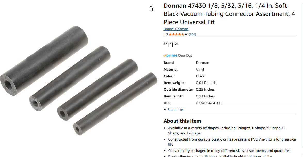

had the same issue where a mouse chew through the white vacuum line used this dorman 47430 the 1/8" to connect the cut hoses together. after connecting the center vents started working but a high pitched squeek or squeel began while driving and pressing on the accelerator it disappears but once slowing down it comes back and its depends on how much of a drop in acceleration happened corelates to the sounds pitch. I am going to see if it is coming from possibly a leak at that soft hose or its collapsing under vacuum pressure. any thoughts on resolving would be helpful.
