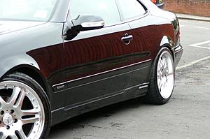

Sorry about the quality its from my camera phone......spacer vs not
No Spacer
No Spacer
So ya looks f'in great, been meaning to do this for a while but cannot understand this wierd rubbing sound im getting. Im getting this clink click sound only once per rotation of tire, so its not a constant rubbing sound. Got under the car looks very clear of everything, does not seem to be anything inside the fender. Maybe the spacer is not seating right with the rotor or with the rim..... any ideas, ATM doesn't make any sense? It was consistant on both side of the car, torqued to 85lb. Irritating such a simple install left me scratching my head for some hours!
One note on top of that seems to have no noise under 5 mph but over that speed clack.. clack.

Check your bolts. If one or more of the bolts securing your spacers are too long, they can interfere with the emergency/parking brake mechanism inside the hubs of your rotors. If you're getting just one click per rotation on one side, it may just be one bolt protruding enough to do it.

I second that....a bolt is hitting the ebrake pin casuing it to click....I found out the hard way

yeah, its a bolt hitting the parking brake. you need to stop driving the car and need to get shorter bolts, else you will really mess up the rear brakes and have a fun time repairing that.

Ya i only drove a few feet it was dark and gf was hurrassing me to take her to dinner, so i took it off. But im pretty sure the spacer bolts are shorter, but did not think into account the thickness of the rim and the spacer bolts sit recessed.
I'll have to relook into this when i have time thx guys.

took a look at the spacer bolts. Looks to be a slight knick at the very edge of the bolt.

i drove it about 5-10 feet....click click click....my ebrake pin was bent....price of the pin is like 4-12 bucks.....stealership wanted 600+ to repair...i denied and ordered the part and fixed it myself....its kind of a pain as u have to remove the whole hub....but dont drive around with it....measure ur bolts with ur wheels off.....stick the lug bolt through the hole of the rim and spacer and take a ruler and measure no more then half an inch of the shank sticking out..if there a bit longer just take em to a machine shop to cut em.....6-8 full revolutions of the lugbolt and ur good...

H&R type "DRA" 20mm
I'll try that out hope i lucked out and the e-brakes are cool.
Checked out the bolt and it was barely knicking it

BTW ebrakes are cool... phew

So i grinded down the bolts, its installed been driving around a bit. Rubs kinda harsh on the top of the tire (not on the sidewall) with the fender. Love the new look and feel.
Though I may have to back down to 15mm and also roll the fenders a bit. Tires fit kinda square with the rim 8" and 255/35.
