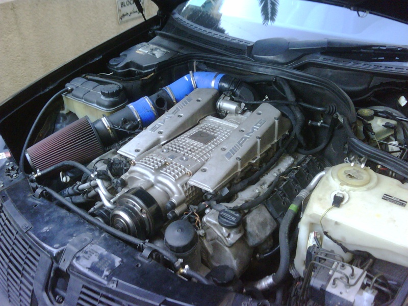

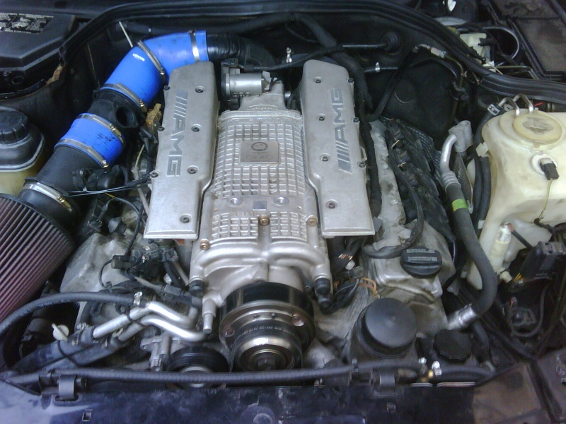

Greetings,
Teaser pics of what i have been up to the couple of months
BIG special thanks for my friend Ali Saklaoui (Autodynamics Garage ~ Beirut Lebanon) for making all this happen.
Newly Added to the car :
# w211 E 55 Kompressor Superchargercomplete Take Off
# w203 C 32 Heat Exchanger with OEM Water Pump
# w220 S 55 Transmission (non Kompressor)
# w211 E 55 Kompressor Spark Wires (~8.5mm)
Car still retains MAF and ALL w208 ME2.8 Electronics, Custom Tuned By Jerry Thornton.
Still need alot of fine tuning waiting for parts to arrive

the car came with originally as a 2001 clk430, swapped the engine for a 500 from a w220 (changed the oil sump and oil pan to sit in the clk bay), then slapped on the e55k supercharger, needed bigger injectors and a custom tune to do that. The car now is a complete "*******"
w220 S500 engine, w220 S55 NA transmission, w211 E55K supercharger, w210 E320 3.07 differential, w208 CLK 430 ECU, "AMG" TCU i have speed shift .
now looking for big brakes, Methe system, oil catch can, and maybe a bigger crank pulley (168 mm "old renntech one") ...

still have a problem in fueling at high RPMs, but i tried a ghetto 1/4 mile run (we don't have drag strips nor do we have a "functional" dyno in Lebanon ) it does 112 mph, this is with a cylinder misfire, and very very bad traction ... so based on a formula on http://www.aspracing.com/index-5.html, which i put my cars weight then trap speed it gave me HP, then put the HP and Weight in the formula below it gives me an estimated time ...
values i plugged the first formula are
3461 lbs, and 112 mph gives me 379 rwhp
then plugged these in 2nd formula below
12.17 secs
yesterday i tried to pull next to a friend that has a M5 V10 (507hp) from a rolling start of 20 mph on the first gear he pulled a car length due to very bad traction then i caught him on second gear my car's nose on his front doors, 3rd gear stayed the same, until my car misfired and we stopped. my car is running in a very safe setup, ignition retarded very much from original (~14 degrees) and with low octane fuel in DAS software too and AFR is between 10~11.5, when i finish from the fueling issues & an aggressive tune we are expecting much much better results

i am re flashing the stock 430 ECU, to accomdate for the 55k injectors, retard timing, remove load limit, change MAF readings for the increased air... all done by Jerry Thornton he does magic with his files...

well the bosch 044 pump was quite an easy install, but u need the right fittings and u need to fabricate a clamp instead of the small one already there, i also had to raise the pressure to 5bar (using 1:1 fuel pressure regulator) to make the e55k injectors happy, the most annoying thing is the sound, and i have a feeling that when it whines too loud its heating the gas which is a performance draw back. there are people who covered it with a layer of rubber and no longer have an issue with the sound, but i don't think this will help regarding heating.
as for the 8 ribbed setup, as u probably know the e55k has 2 belts, u will need to buy all the pulleys of the e55k including one small bracket for one of the pulleys didn't find it in the us got it from a dealer in germany. i have the part number if u like. Also u need a tensioner and a new water pump, in my case i also needed the thermostat with housing too. but i suspect this will work right in your kleemann setup, did u look under the hood of the C32/slk32 crossfire srt6? they should be identical to the m113 engine but with 8 rib instead of 6 rib?? just food for thought...
i will really be glad if u can ask the guys how built up your transmission if they can sell me a kit? and i install it locally here? i already swapped out the soliniods to the blue tops one, shifting is firm, but i feel its slower
