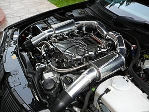

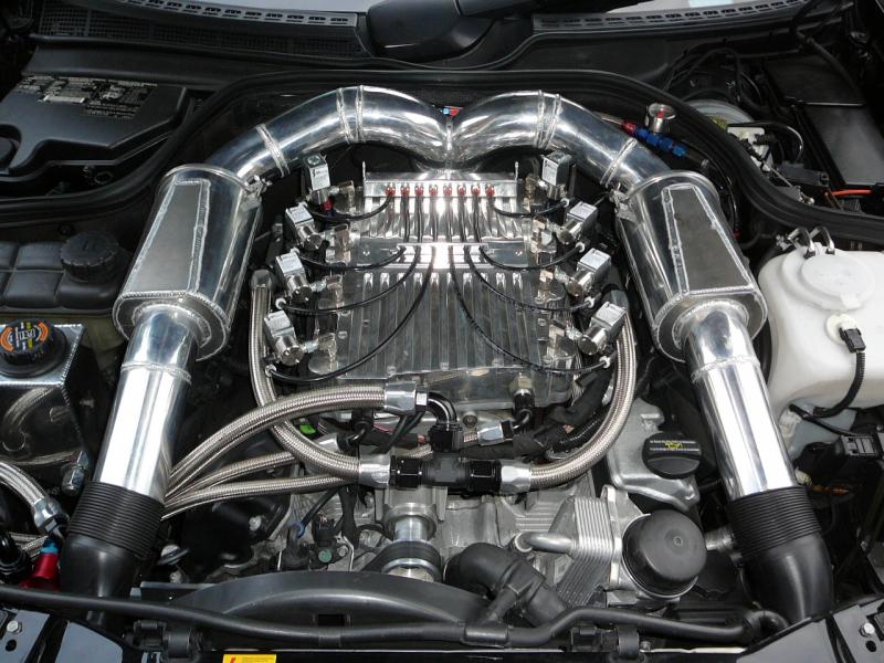

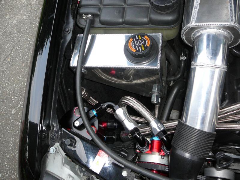

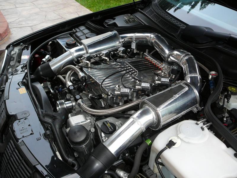

I been running this for a while now. Its a must have for forced injected motors. Im using M1 methanol 100%, no water mix.
Attached Thumbnails methanol injection?-p1020613.jpg   methanol injection?-p1020614.jpg   methanol injection?-p1020615.jpg   methanol injection?-p1020616.jpg   methanol injection?-p1020617.jpg

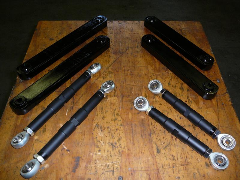

eibach pro kit springs, bilstein stocks, front spring pads r the smallest and rear spring pads are the tallest. And i made a custom rear arm kit ( attached pic).
Looks good. What are the four bars in the rear?

the tubes are the upper and lower arms, the 2 adjustable bars r for alignment
