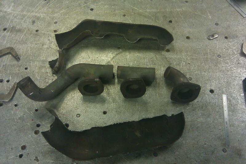

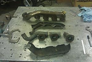

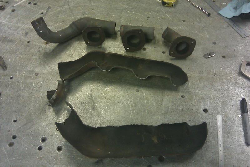

Some time ago, I purchased a set of CLK320 manifolds. A couple of members had requested sets of my headers for this model, so I wanted to make sure we got all of the dimension correct and not just guesstimate off of the V8 set we had been using.
So once we got everthing mocked up, we cut one open to see how they worked and I would say it was interesting to say the least.
As you can see from the pictures, the exit tubes are actually just slip fittings that expand from the heat of the exhaust and the whole things is kept together with the outer casing.
Attached Thumbnails Anatomy of a Manifold-imag0080.jpg   Anatomy of a Manifold-imag0081.jpg   Anatomy of a Manifold-imag0085.jpg

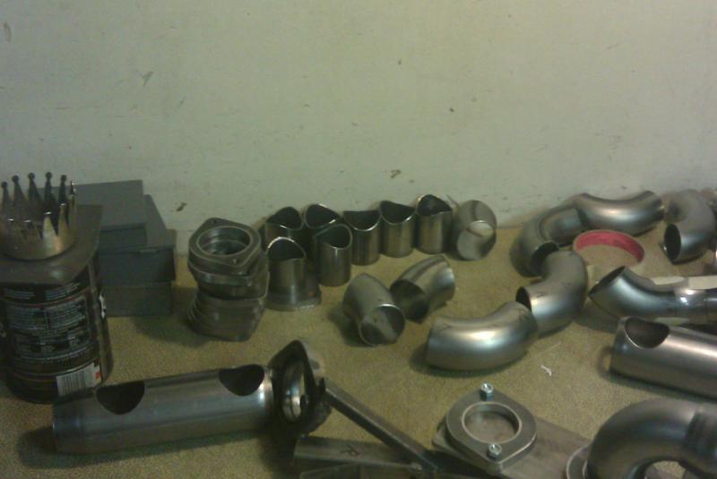

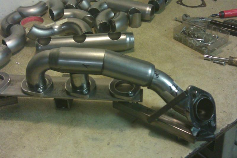

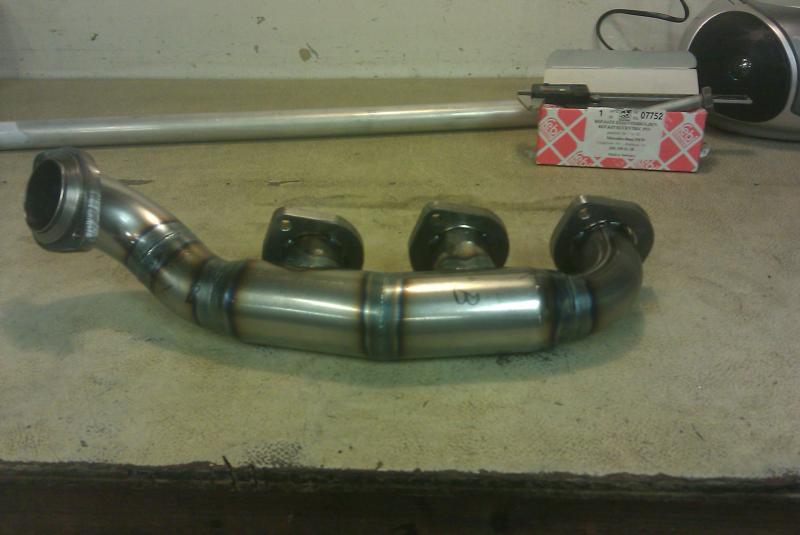

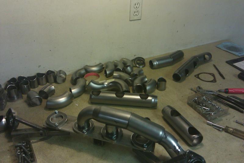

Here are some pictures of the headers during production:
Attached Thumbnails Anatomy of a Manifold-imag0082.jpg   Anatomy of a Manifold-imag0083.jpg   Anatomy of a Manifold-imag0084.jpg   Anatomy of a Manifold-imag0094.jpg   Anatomy of a Manifold-imag0095.jpg

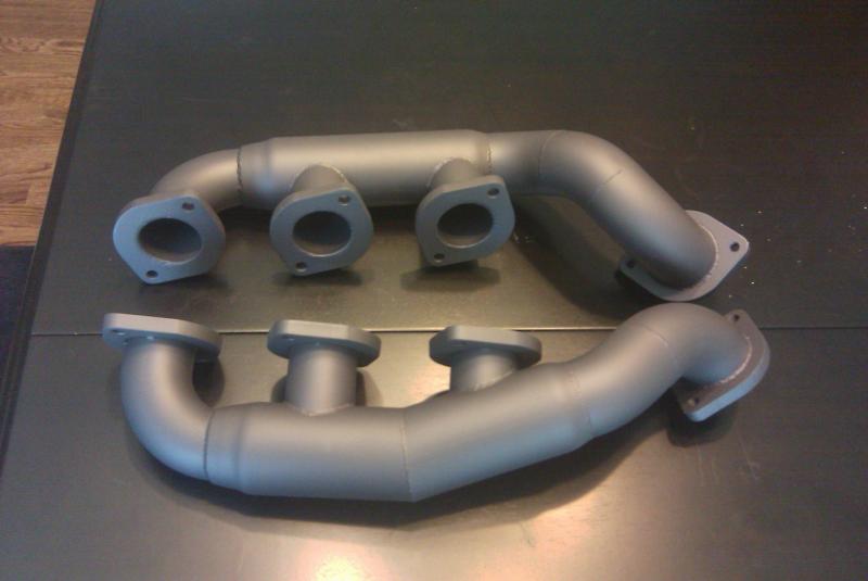

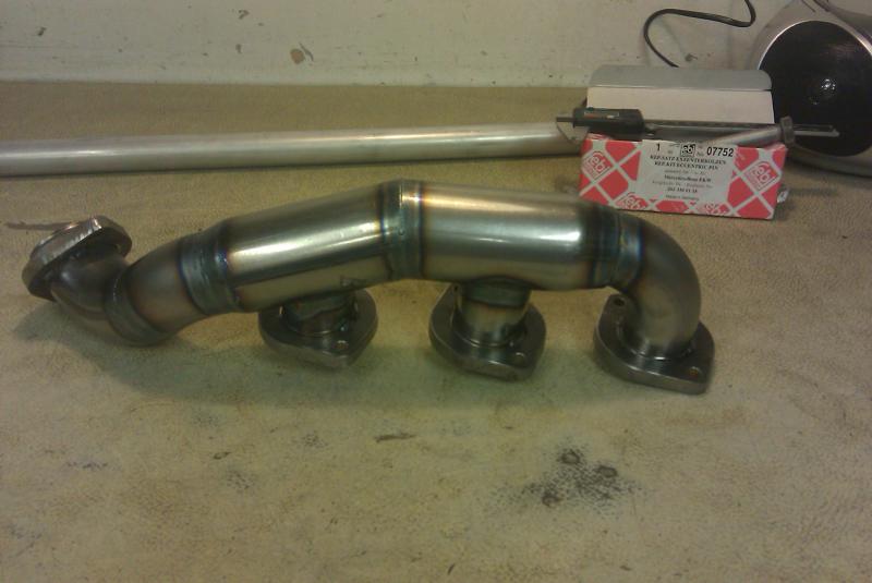

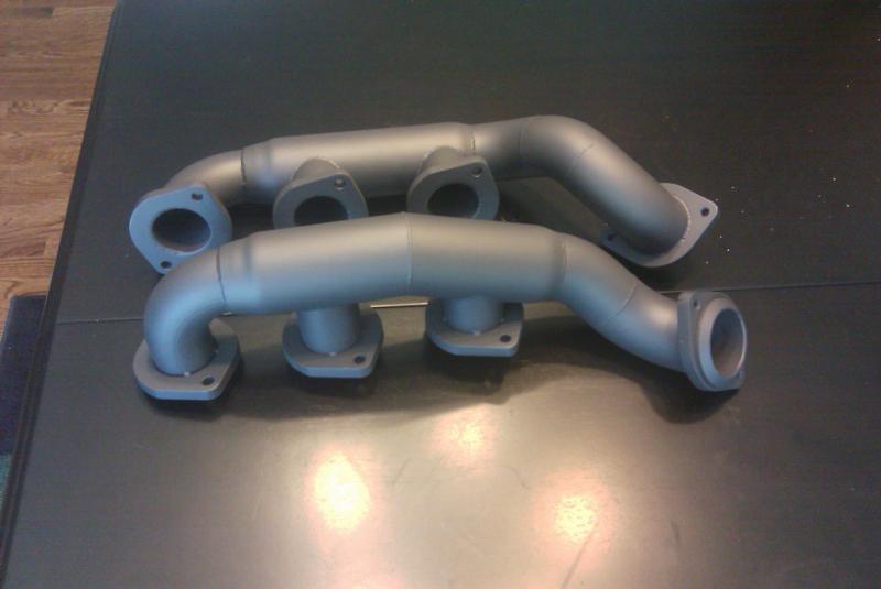

Here is what the finished product looks like:
Attached Thumbnails Anatomy of a Manifold-imag0088.jpg   Anatomy of a Manifold-imag0089.jpg   Anatomy of a Manifold-imag0090.jpg
