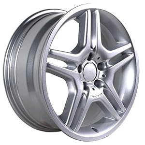

yea wheels...........it i give it any more thought.......i think I'm going to go chrome. I'm with you trudawg on the AMG style these ones look good, but I live in a very sunny place and I love that chrome look, that reflection in the sun kicks.
I think the larger wheel at the back is also good look.
