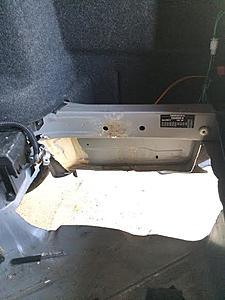

Well everyone, this has been talked about plenty of times but finally, my quad exhaust is in the works. My plan is to have an electric cutout for my secondary cats so I can have them functional or not an any given time for emissions and noise purposes. After the cats, I will use a y-pipe to feed exhaust piping to the right side. First things first though, I have to relocate the battery.
Using an original idea from VIPCLK320/55, I'm in the process of relocating the battery about six inches upward. Today, in about a half hour, I cut an approximation of the hole so the exhaust will fit. Tomorrow will be full of sanding and welding.
Updates to come.

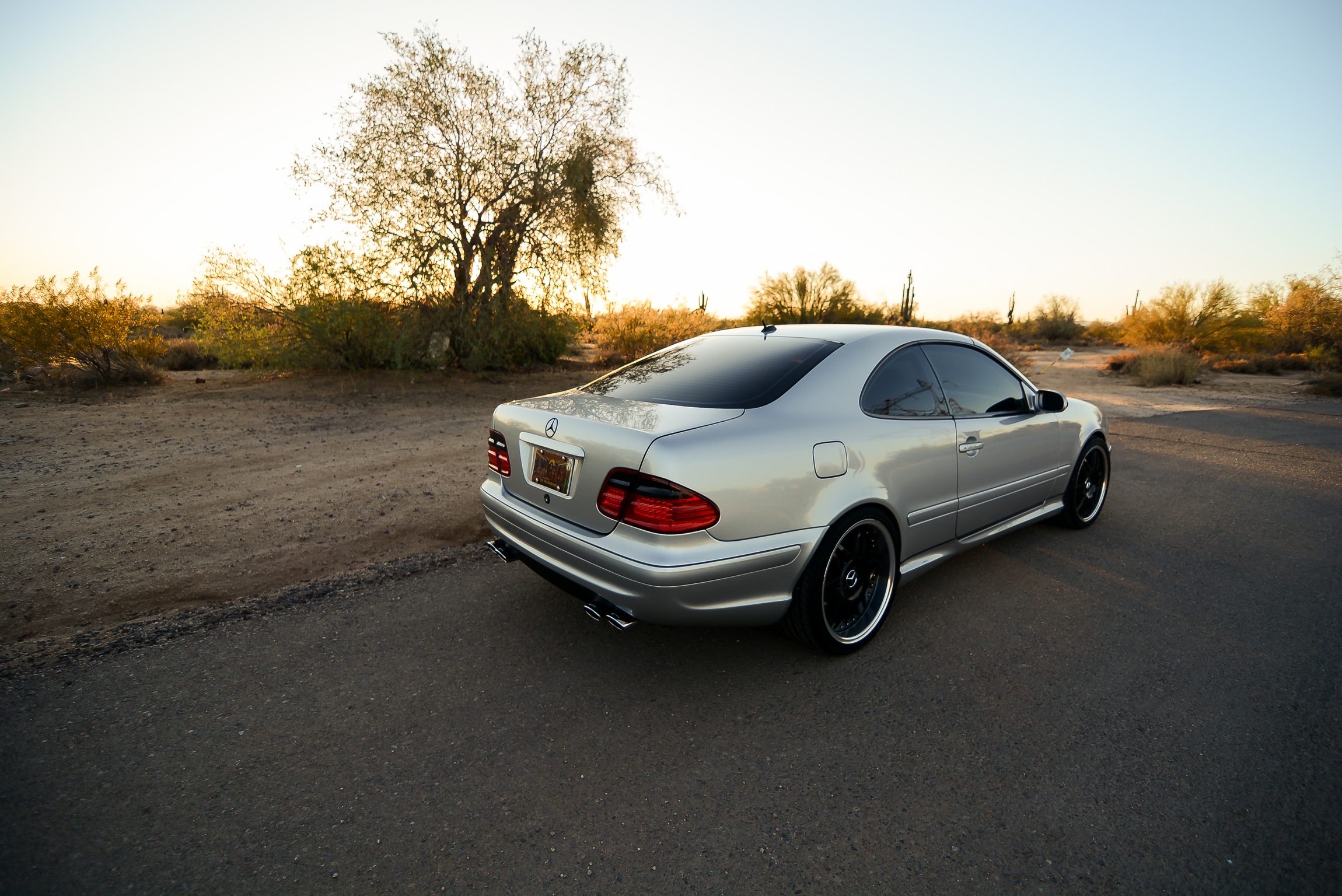

Update: Project complete
Just need to re-align the tips a little bit.

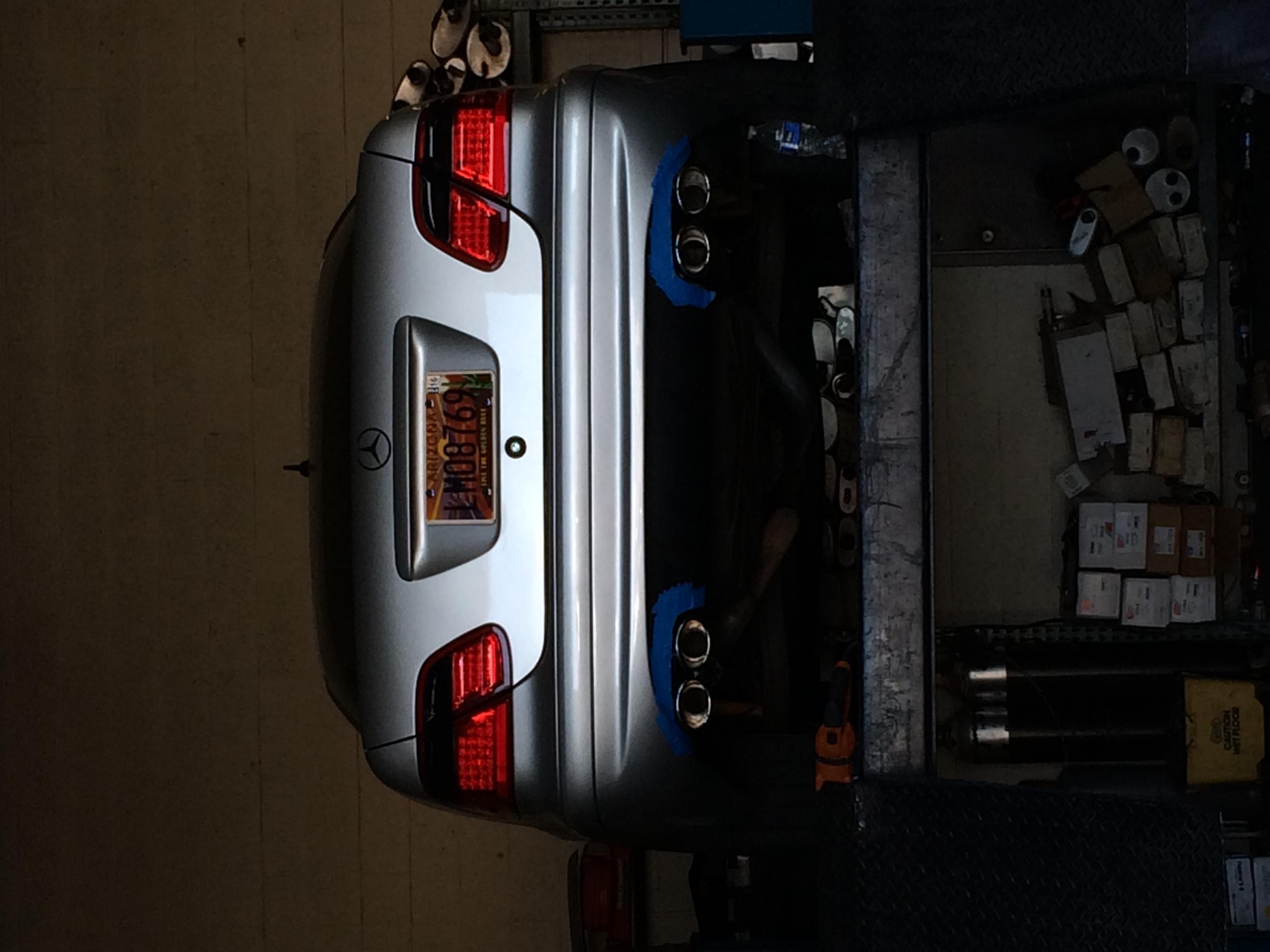

Old Jul 4, 2014 | 09:14 PM
TIMO 55's Avatar
Joined: Jun 2006
please can you post more pics,looks great job !
Old Jul 4, 2014 | 09:16 PM
TIMO 55's Avatar
Joined: Jun 2006
from where did you the rear diffuser ?

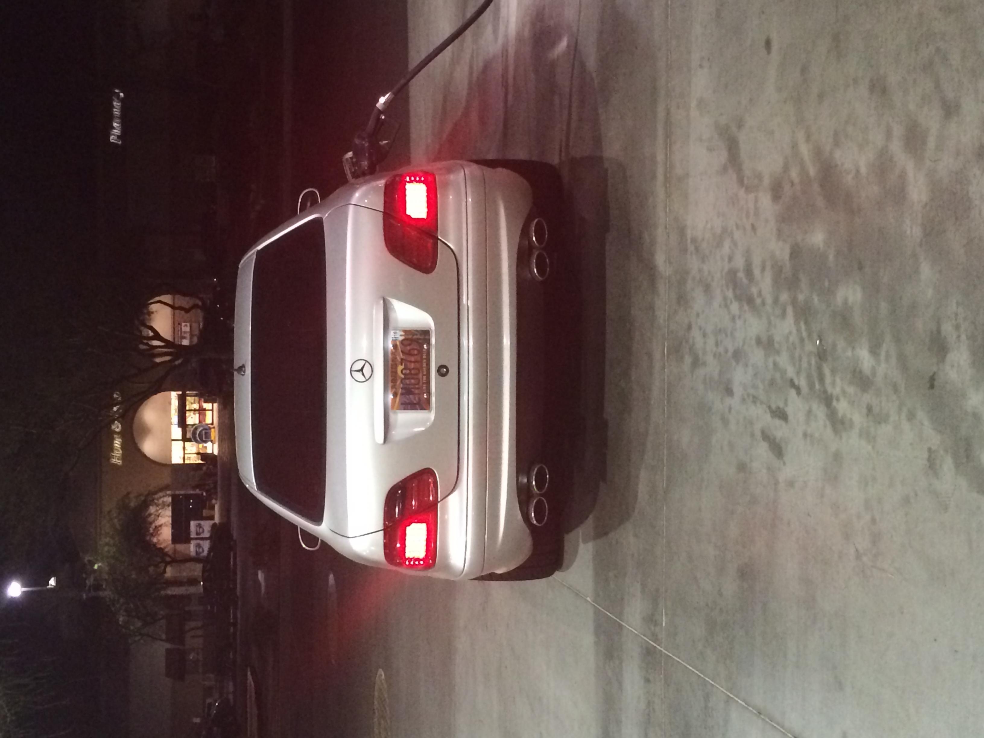

Sorry for not posting sooner, I was busy traveling. Here are some quick iPhone photos.
Attached Thumbnails Quad Tip True Dual Exhaust-photo-7-.jpg   Quad Tip True Dual Exhaust-photo-1.jpg   Quad Tip True Dual Exhaust-photo-2.jpg   Quad Tip True Dual Exhaust-photo-3.jpg   Quad Tip True Dual Exhaust-photo-4.jpg
Old Jul 29, 2014 | 12:22 PM
sz01361's Avatar
Joined: Apr 2014
Posts: 51
CLK230 W208
Hi,
Whats your rim and tire size? Love the look of it!
Like you, I plan to upgrade rear light to LED model. Cosmetic/function wise, is it a lot more "dramatic" than original?

Old Jul 30, 2014 | 09:16 PM
CJackson13's Avatar
Joined: Mar 2011
Posts: 267
From: Arizona
W208 CLK55
thanks.
Front wheel: 19x8.5 et32 w/ 245/35/19
Rear wheel: 19x9.5 et35 w/ 275/30/19
To be honest i'm not sure what you mean by dramatic... If you mean far from factory then no theyre not bad. You see cars with those chrome tail lights and such, but the lights for this car are very clean and keep the original style.

Old Aug 9, 2014 | 09:18 PM
CJackson13's Avatar
Joined: Mar 2011
Posts: 267
From: Arizona
W208 CLK55
Forgot to share these pics of the welding process....
I used polyurethane caulk to seal the tiny cracks instead of completing 120 or so inches of welding. Overall It fit perfectly even with the spare wheel.

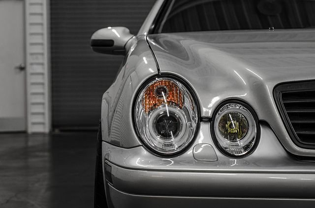

Can you please post couple photos of the front section?

Thanks. Here are some pics. Notice the front offset is off because of the 10mm spacer I needed thanks to buying 245/35 tires. Also, let the pics show that I really, really, really need to make a newer front bumper.
