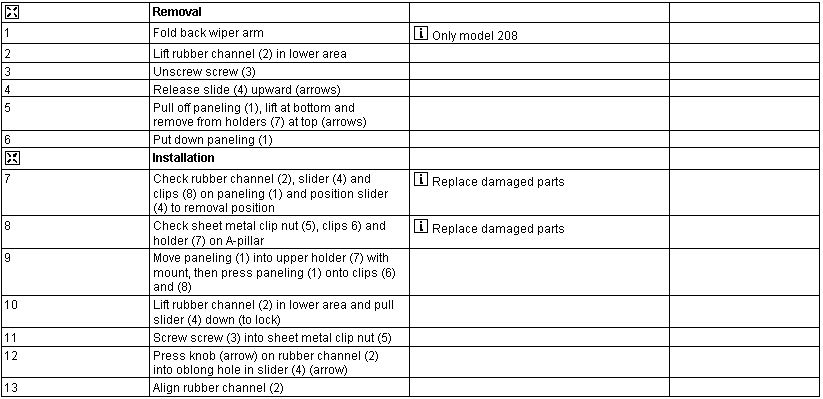

Have to repair some light surface rust between the A pillar cover and the front 1/4 seam. Remember reading when I had access to the WIS a few years ago that there is a screw behind the rubber gasket by the window but there is a procedure to remove it once the screw is out. I don't want to go in blind and start breaking things - so if anyone has access to the WIS and can look this one up I'd appreciate it. Again its the A pillar metal cover along the windscreen for a CLK430 (2000). Thanks.

Hope this helps ya!

IT DOES! Thanks for the effort. Exactly what I was looking for and it will make my life easier.

My vehicle; 1998 CLK 320 - trying to remove the exterior "A" pillar covers
I can't follow this diagram. Is it depicting, peel the trim panel away from the windshield side of the panel, and then 'push' down (toward the base of the panel).
Thanks.

If I remember correctly its move the cover first downward, then at the bottom move left as in the diagram then outward. Think the pins on the pillar cover are like lL shaped hooks. Its been a long time since I did it. Please let me know if that works. Again when the retaining screw is removed slide downward and it should release the panel then lift it out.

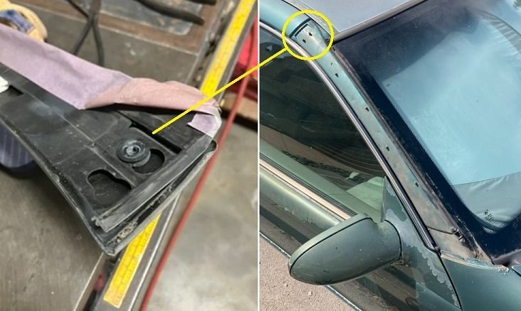

BUMP
1996 C208
Windshield "A" pillar exterior trim fasteners.
Questions:
1 - Does anyone have an on-line source for part diagrams (to look up the part number of this fastener/grommet)?
2 - Are these still available? Dealer only?
