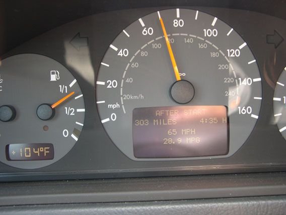

The O2 sensors for a 320/430/55 are all in the same spots - upstream and downstream of the primary cats. A 170 and 173 usually points to one of two things; a bad MAF or worn out O2 sensors. Since O2 sensors are a normal wear part, I'd start with them. That doesn't mean I'm right, it's just where I'd start. O2 sensors go dead on people's cars all the time. The problem is, they do it so slowly that most people never notice. Those pictures you see of 430s getting great fuel economy over long distances are cars with working O2 sensors. Dead ones won't get 28+ MPG because they're always supplying low voltage signals to the ECU.
