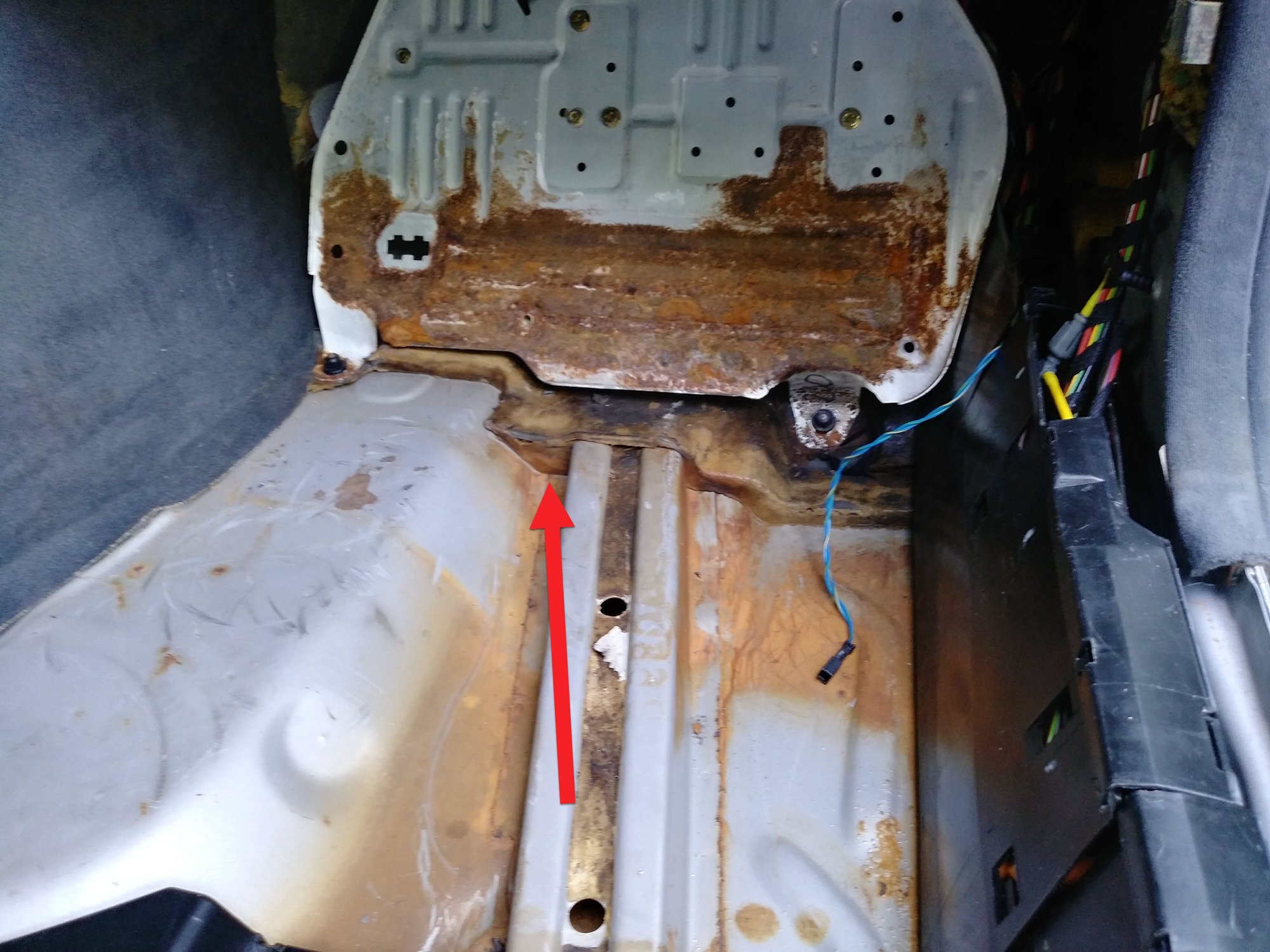

That's definitely worth checking (thank you), but I have had the passenger side torn apart for about six weeks. I spent the first two weeks drying everything out completely and clearing all of the drains, then I let the car sit for the past month (literally) to see if the problem was fixed, but I'm still getting some water in the cabin (not as much as before, but there's still a leak somewhere).
I have confirmed that my vents aren't operating properly, as well as confirming that the fresh air door will not close under any circumstances. I can push it closed by hand, but it pops right back open (like it's spring loaded). That tells me that the movement is fine/the door isn't stuck or hung up on anything. There's a problem with the HVAC system itself.
If you look at the picture below, the arrow is pointing at where the water is coming from (it has the highest concentration of water everytime water gets in the cabin). Hopefully that helps.
I may have two problems: HVAC issues and a seperate leak, but I can't figure out either issue at this point.

Drain at bottom of passenger windscreen.

I had water come in the same exact spot. There is a drain (round, the size of a quarter with a flap) in the engine compartment, below windscreen passenger side. It gets clogged over time and when water builds up it goes over the a damper and runs out the same spot you have marked.

That's exactly what I thought, but I've cleaned every known drain (including that one). They were all clogged - and cleaning them stopped most of the leakage, but water is still coming in from somewhere (and it's not the A/C). I can't figure it out.

It is exactly above...clogged drain in the engine compartment...a common question on forum...do search for water passenger side. Run a long wire down the tube to unclog it...then run some water slowly to completely clear the tube.
BTW, all the flaps of the hvac are controled by vacuum. the tube runs toward passenger side, enters the right wheel well and can only be seen by removing mud flaps. That is where many vacuum lines are broken. There is a vacuum splitter there and the line breaks. The line then enters through fire wall just next to the blower motor...attaches to the vacuum distribution box that controls all the flaps...do a search, I posted pics of all the above.
