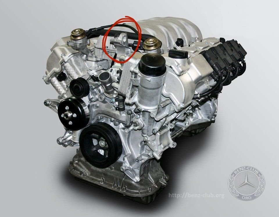

Paint is an insulator connect the negative to the hook on the engine to complete the circuit circled in red. Remove the engine cover to access.

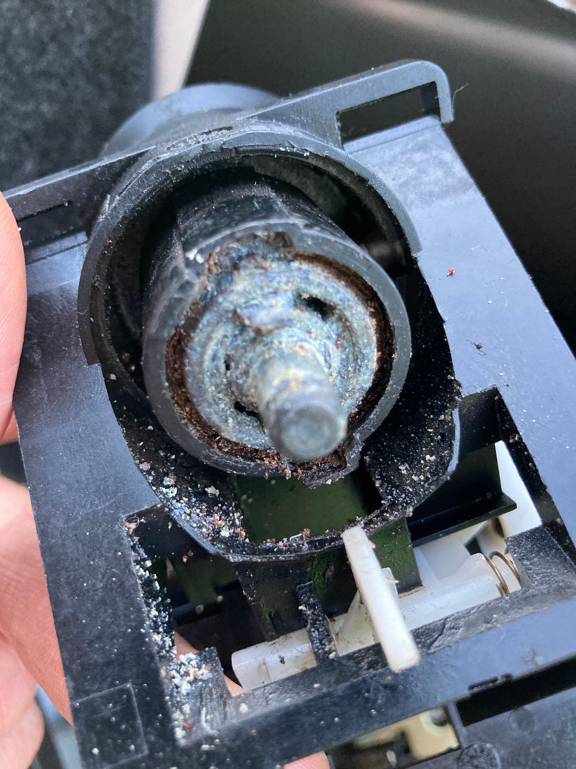

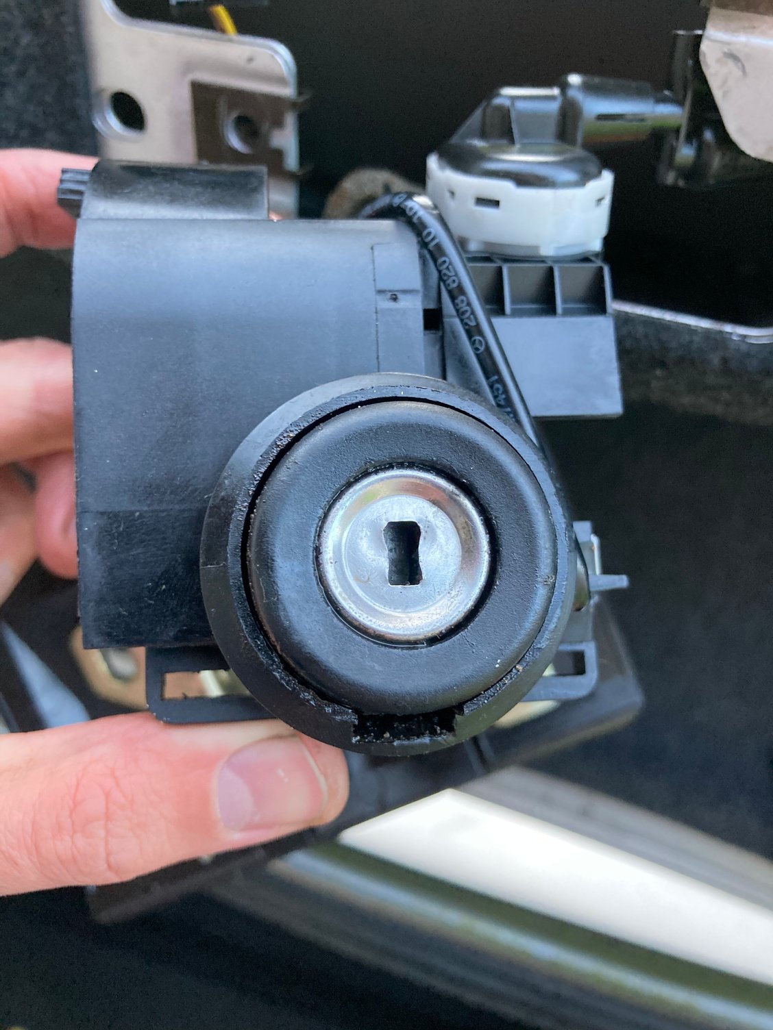

Well after nearly 2 weeks of trying to get the boot open I have had to force entry but at least i’m in.
There is a great write ups on taking the boot lock apart to get it working again. Just struggling how to get the lock cylinder out of the mechanism. Have removed the plastic parts and the snap ring and still won’t come out. Any ideas ?
Thanks again
