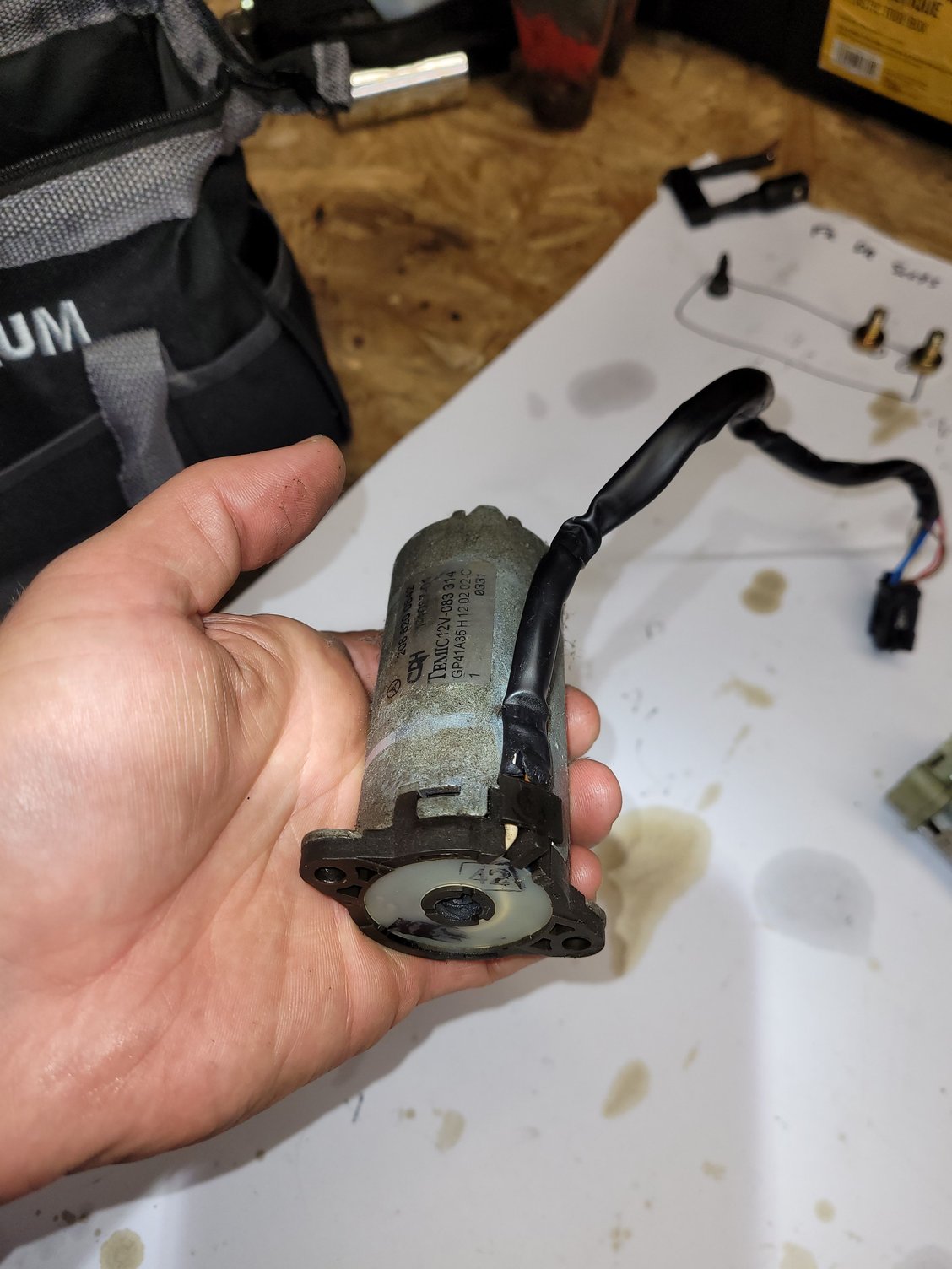

No need to remove seat
Also, I just did the exercice, with seat locked in max forward position (worst case scenario), it is feasible to replace it without removing the seat.
Torx socket, 3/8 flex joint, extension and 3/8 ratchet. First motor removed on this one to get access to the second one (forward/Reverse)
The guilty engine.
How the seat was stuck.
