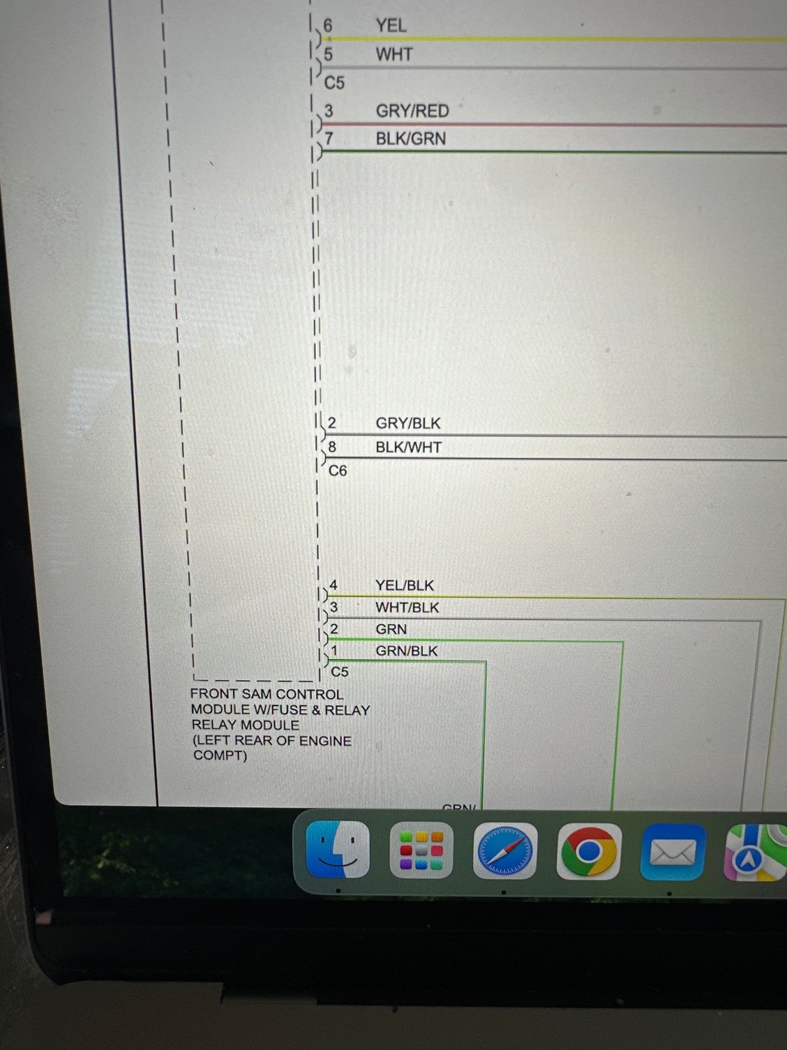

I’m looking at a schematic and it says that the parking lights and headlights going to a front Sam control module with fuse and relay relay module left rear of engine compartment. Now do they mean left rear when you’re standing in front of the car or left rear when you’re inside the car cause if you’re standing in front of the car, left rear of engine would be behind the battery. Now I did hear some things about something there, but I know from a fact that the Sam is to the right with all the fuses. Am I missing something?
These are the parking lights, though I can’t find the side marker lights on a schematic. I see low high park and turn, but I don’t see anything about a side marker lights schematic
