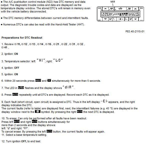

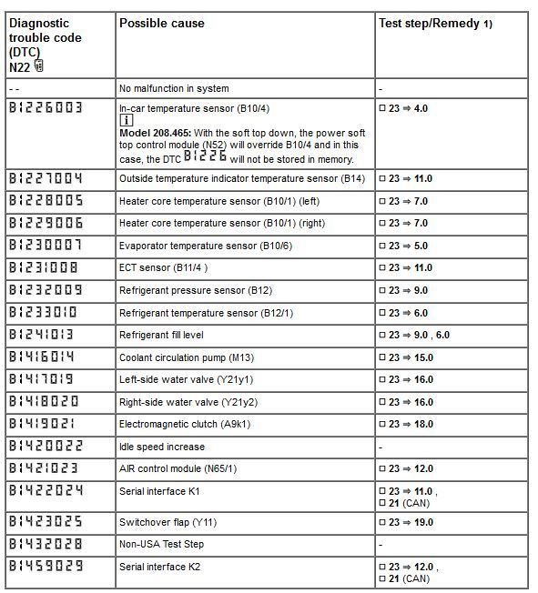

Be careful of what you're being told, as our N22 HVAC controller is capable of providing the necessary diagnostic trouble codes , as well as the current HVAC system values, you'll need to repair it.
Following are Instructions to get both the diagnostic trouble codes and current system values.

Originally Posted by Serndipity
Hello Frupal,
When it says ignition on - does this mean with engine running?
Old Oct 11, 2025 | 03:32 PM
Serndipity's Avatar
Joined: Nov 2001
Posts: 1,258
Likes: 209
From: Boston North Shore
2001 CLK320 Cabrio
Q: When it says ignition on - does this mean with engine running?
A: Yes

It’s been a while since I last ran the trouble codes on mine, but I think it’s just ignition on with engine not running. Mine came back with low pressure, and the red EC light always on. Is your EC light on? What are your system pressures?
