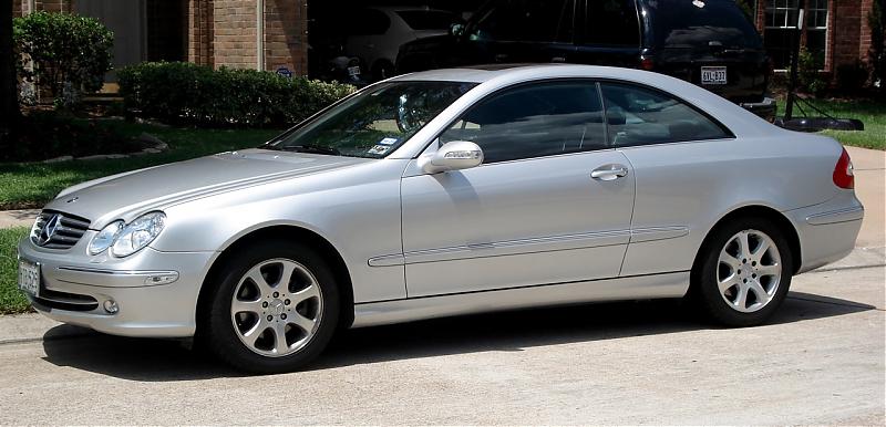

Here is the before....

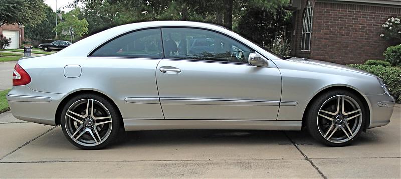

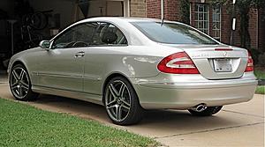

Here is the after....
Definitely needs to be lowered......

WOW, those look way better! Changed it from a boring passenger car to something sporty.
Personally, the diameter is too big for my tastes, but it definitely works.

How's the ride in terms of quietness and handling compared to the stock 17's?

Looks great!
Time for a lip spoiler...

Over bumpy roads you can notice a difference, but it is not annoying by any means. The road noise is actually the same or less than the stock 16"s (Continentals).
I like to feel of the wheels when cornering also. The rear seems to hold the line better now.....

Looks great.
When you lower the car, you will notice such a difference with it's look..... There is so much more of an aggressive stance when it's down and inch and a half.
I used Eibach, but I went with them because I got a deal on the price. Either one you choose will work out for you. It's just personal preference.
