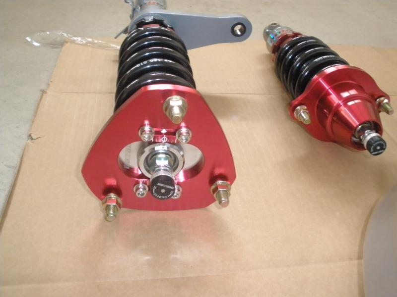

No !! Coilover suspension come in many stages like 1,2,3..etc. The higher stages allow you to do more adjustment. For example on the KW coilover for Mercedes, stages 1 with only ride height adjustment. Stages 2 with ride height and damper adjustment. Stages 3 with ride height, damper and re-bound adjustment. As for camber adjustment, I have not seen any kit for Mercedes that have camber adjustment build into. Here's a pictures of my 2004 Honda civic Megan's Racing coilover kit that I installed last month with ride height, damper and camber adjustment.
