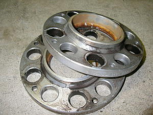

Check out these "custom" 7mm and 12mm spacers from Lorinser. The 7mm spacer does have lip. This is what I mean by "custom".
Attached Thumbnails Problem with wheels HELP-picture_150_167.jpg   Problem with wheels HELP-picture_152_168.jpg

The standard 3-5mm spacer in the catalog does not have lip. To get it with lip, it would have to be special custom made.
