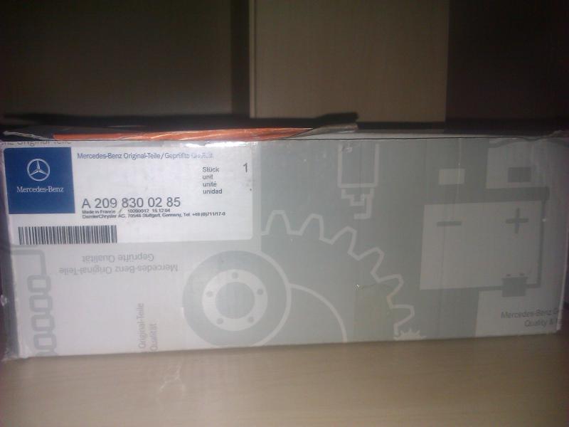

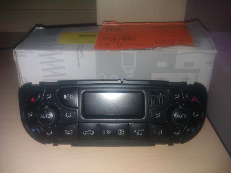

This came today.
One of many more parts to come in mikata's spring mods round two

Originally Posted by mikata
This came today.
Going full Thermotronic are you?
Old Dec 27, 2011 | 08:45 AM
  #283
mikata's Avatar
Posts: 1,595
From: Sweden
Mercedes CLK 320 W209
Just a plug and play swap.
But out of curiosity, what do you mean with full Thermotronic?

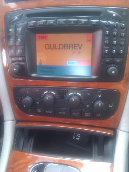

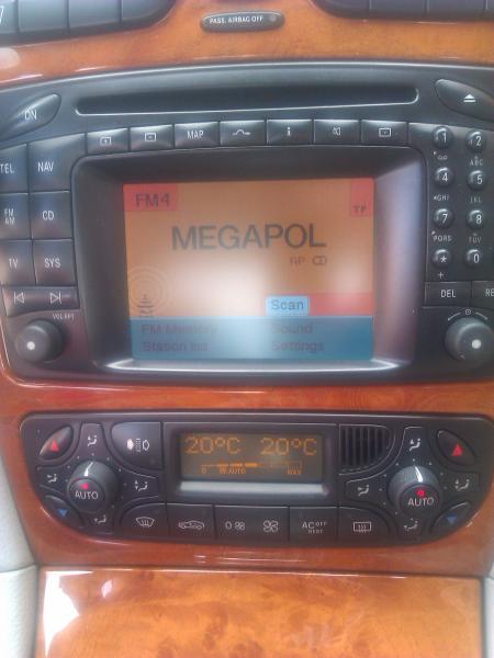

Time to dust of this thread a bit.
So I've had the digital luxury climate in storage for a while(almost 8 months), I haven't really had time to install it, but I had the chance to do it today.
Chris/clk63dk and I spent a few hours fiddeling with the car and planning my upcoming audio mods.
The install of the climate control only took 10 min btw.
When we both get a chance(hopefully in the beginning of next month) we will install dension gateway lite and Helix amp for my Helix speakers.
On my 40min drive home I noticed my air ducts only blowing hot air no matter what I had set on the climate control.
I knew I had to reset it, but since I was on the freeway, there was no chance of pulling over and reseting it so I turned the AC off.
So 40 sweaty minutes later I got home and reset it.
How to reset pre-face digital climate control:
A reset of the unit should be performed so the position of these flaps are reset and learnt. To reset the unit hold down the demist and recirculation buttons for > 5 seconds, if successful both LEDs flash and the unit will cycle the flap motors to normalise their posotion.
Reset should normally take 30sec or so but mine took way longer and I had no patience to wait so I shut the car of and turned it back on and go figures everything works as it should.
A before and after pic.
Attached Thumbnails Mikata's spring mods-img_20120812_152541.jpg   Mikata's spring mods-img_20120812_154128.jpg

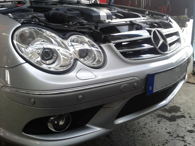

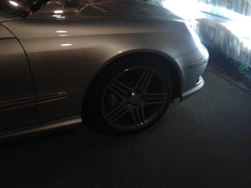

I haven't really done much to the car more than installing Eibach springs(lowered by 30mm) and bi-xenon headlights last weekend. Few pics attached.
I have two more mods to do, after that I'm done modding it. I just want to enjoy it as it is.
Things left to do are:
*True dual exhaust
*6/4 pot brakes(whenever I find a good deal on the brakes).
I'm getting the C55/CLK55 spare wheel well for this setup.
Mufflers I'm getting:
http://www.ebay.de/itm/Fox-Sportausp...item19dd1235c4
Hopefully I'll have the exhaust setup done by the end of this year.

Nice bumper
