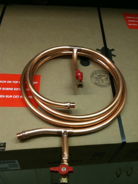

So I've been getting water in my compressed air system lately and that's not helping too much with the plasma cutter so I came up with this:
1/2" copper tube with fitting adapters and two water trapsI'm going to move one of them to the end and put a 90 degree elbow with a T to supply the air system so it will "catch" the water better. This whole thing will be mounted to the window unit AC to get more of a cooling effect for the air.
