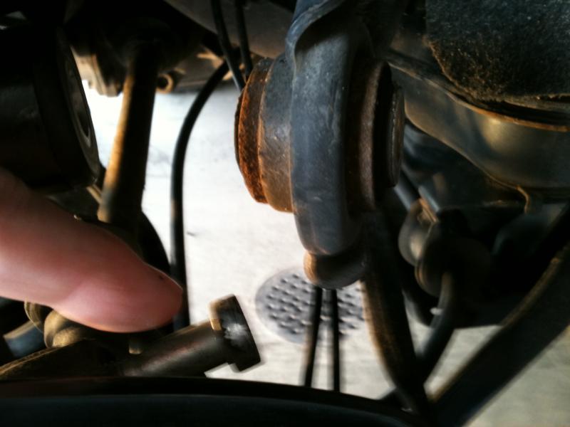

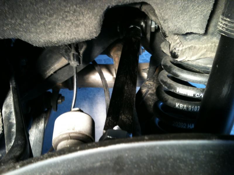

Finished up. After the first side it was pretty easy. Here was the catch with the install;
Where the oem camber strut attaches at the hub the torx bolt head can't be removed to remove the strut without taking the other strut bar attached just below it that attaches back to the frame toward the front of the car. I attached a half *** photo of it.
2 Jacks are needed. One to rise the car, and one under the hub assembly frame to then lower the car onto slowly.
Then its just a matter of raising or lowering the jack under the hub to get things lined back up. It takes a little pushing and pulling.
Some of the bolts are a little tough to get at. Wrenches are the only tools that will get where you need to get.
The car now appears to be sitting very nicely with maybe a bit of positive camber that I'm sure will settle after driving a bit.
It was about to rain so I will post up pictures from the rear and post.
